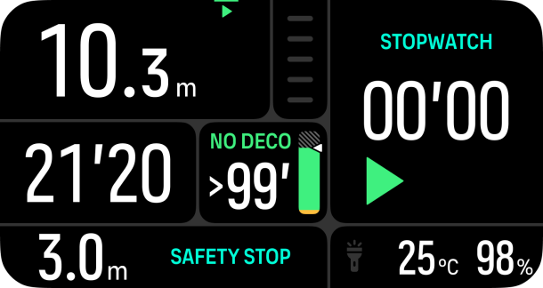

The Suunto Nautic has a timer that can be used for timing specific actions on the surface and during diving. The timer can be configured to be present in the switch window. See Switch window customization.
Start and stop the stopwatch by short pressing the back button. You can resume by short pressing the back button again. Reset by long pressing the back button.
stopwatch-1
NOTE:
The timer button functions are active only when the stopwatch is active in the switch window.
