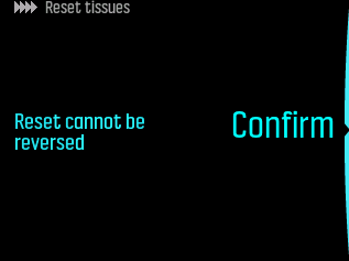

  2. Press the middle button again to confirm.
    reset tissues confirm
