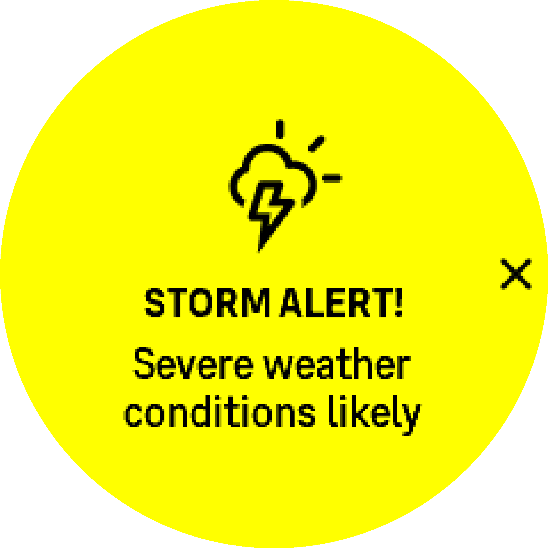

Storm alarm
A significant drop in barometric pressure typically means a storm is coming and you should take cover. When the storm alarm is active, Suunto Ocean sounds an alarm and displays a storm symbol when the pressure drops 4 hPa (0.12 inHg) or more during a 3-hour period.
To activate the storm alarm:
  1. From watch face, keep the middle button pressed to enter Settings.
  2. Scroll to Alarms and enter the menu by tapping on its name or pressing the middle button.
  3. Scroll to Storm alarm and toggle it on/off by tapping on its name or pressing the middle button.
When a storm alarm sounds, pressing any button ends the alarm. If no button is pressed, the alarm notification lasts for one minute. The storm symbol remains on the display until the weather conditions stabilize (pressure drop slows down).
Storm alarm active S9PP
