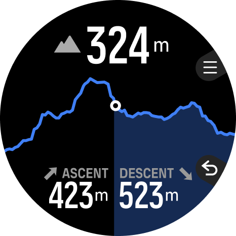

If you are navigating a route that has altitude information, you can also navigate based on ascent and descent using the altitude profile display. While using navigation, turn the crown to switch to the altitude profile display.
The altitude profile display shows you the following information:
  • top: your current altitude
  • center: altitude profile showing your current position
  • bottom: the ascent and descent done
altitude nav dilu
If you stray too far off from the route while using altitude navigation, your watch will give you an Off route message in the altitude profile display. If you see this message, scroll to the route navigation display to get back on track before continuing with altitude navigation.
