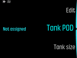

Alternatively, you can pair your Suunto Tank POD from the menu:
  1. In the Gases menu, select the gas you want your Suunto Tank POD to pair with.
    eon menu pairing select gas
  2. Press middle button to open the gas settings and select Tank POD.
    eon menu pairing select gas settings tank pod

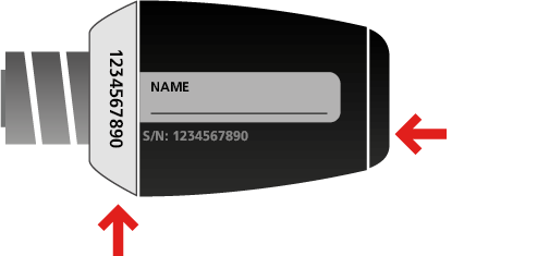

WARNING:
If there are several divers using Tank PODs, always check before you dive that the POD number of your selected gas corresponds to the serial number on your POD.
tank pod serial number new
    D5 menu pairing not assigned
    D5 menu pairing gas selected pod not assigned

WARNING:
