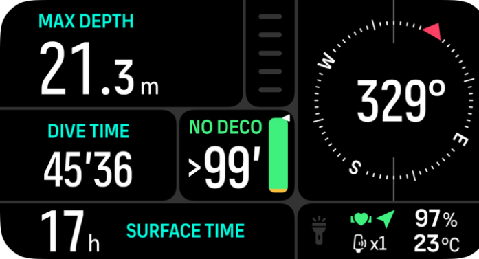

Surface screen and dive options
The surface screen is the same for all dive modes, but each mode has several dive mode specific options that can be adjusted to your diving needs.
A set of icons appears on the surface screen, depending on what you are using with the dive mode, such as heart rate, Tank POD and GPS. The following elements can be seen on the display:
  • Max depth from previous dive
  • Dive time from previous dive
  • Time at surface
  • Tank POD icon if linked and active
  • GPS signal if enabled
  • Heart rate belt icon if enabled
  • Remaining battery percentage
  • Temperature
  • Switch window content
GPS signal: The arrow icon (connected GPS) flashes gray while searching and turns green once a signal is found. We recommend to wait for the GPS icon to turn green before jumping into the water for accurate GPS location.
Heart rate: The heart icon flashes gray while searching and once a signal is found, it turns into green. See Pairing heart rate sensor.
Tank POD: The tank icon is only visible if you have a Tank POD paired to your gas.
surface screen
