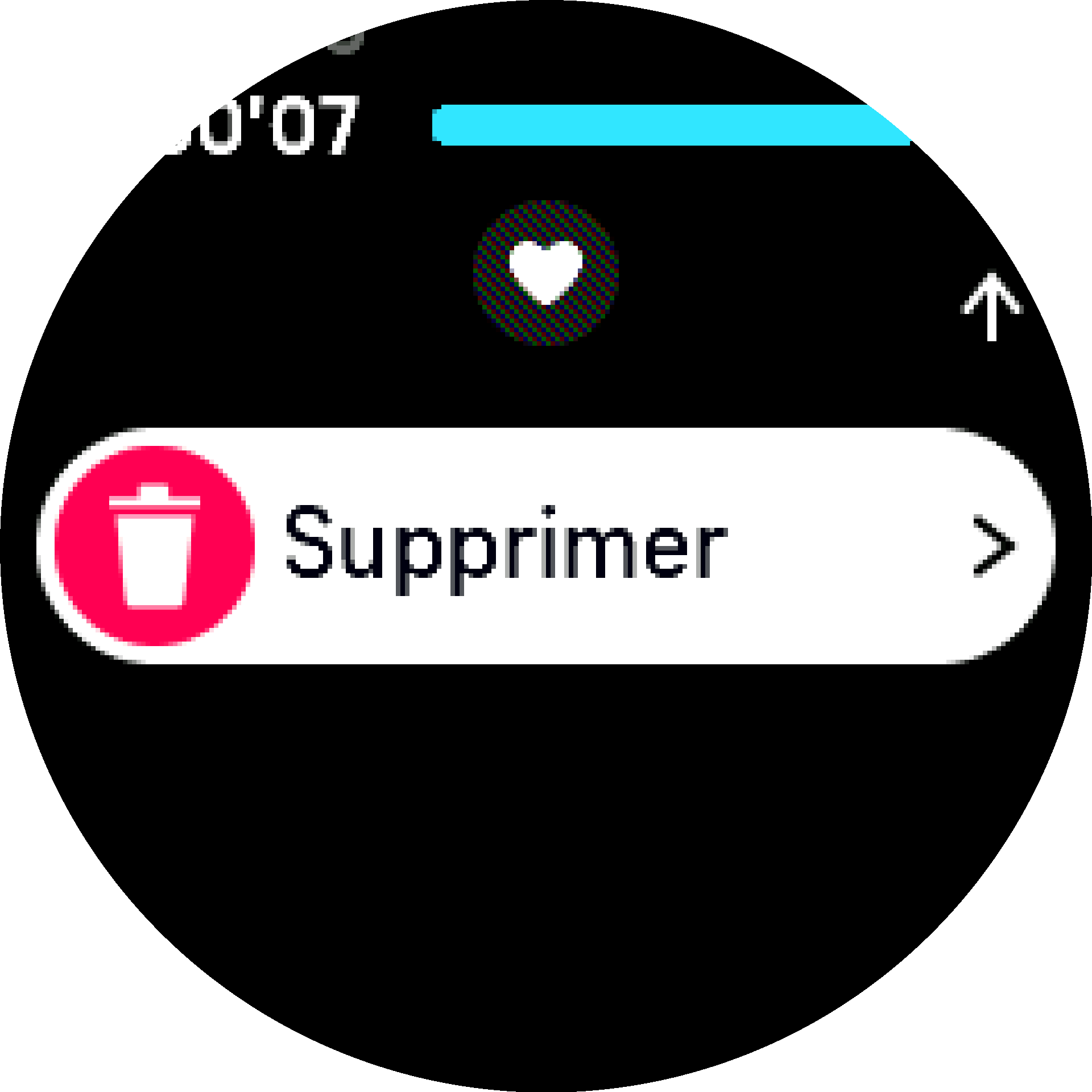

After you stop the recording, you are asked how you felt. You can answer or skip the question (see Feeling). The next screen shows a summary of the activity that you can browse through with the touch screen or by turning the crown.
If you made a recording you do not want to keep, you can delete the log entry by scrolling to the bottom of the summary and tapping the delete button. You can also delete logs in the same way from the logbook.
Delete Exercise S9PP
