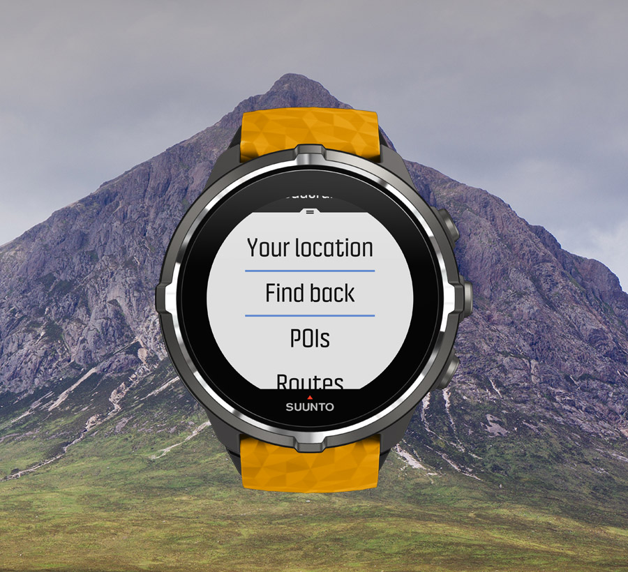

Another handy way to navigate with Suunto Spartan is to use its Find back feature. If you are using GPS when recording an activity, Suunto Spartan automatically saves the starting point of your exercise. With Find back, your watch can guide you directly back to your starting point.
While the breadcrumb trail leads you back to the starting point along your original route, the find back feature shows you the direct direction and distance to the starting point.
To start Find back navigation swipe left or press the middle button until you have reached the navigation display. (Note that you need to be tracking the entire activity from the beginning for the watch to know your starting point.)
Swipe up or press the lower right button to open the shortcut menu. Scroll to Find back and tap the screen or press the middle button to select.
Once Find back is selected, the navigation guidance is shown as the last display on the selected sport mode.

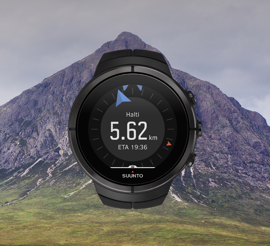

While exercising, swipe right or press the middle button to scroll to the navigation display where you will see the route you selected. You will see your position in relation to the route. If you leave the planned route, the watch will show an Off route message. You will also see the track you have traveled as a breadcrumb trail.
You can zoom in and out by tapping the screen or keeping the middle button pressed. Adjust the zoom level with the upper and lower buttons.
If you have entered waypoints on your route, your watch will notify you as you approach them. These same notifications work also when navigating to POIs. When customizing sport modes you can also add ETA (Estimated time of arrival to a waypoint) and ETE (Estimated time to route’s end) as data fields.
