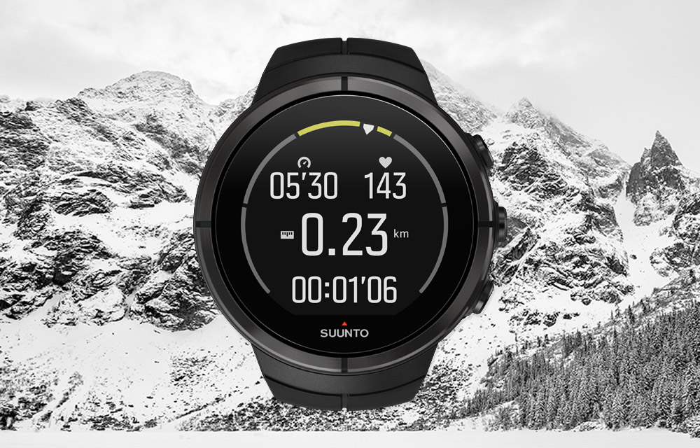

HOW TO USE HEART RATE ZONES DURING TRAINING
Heart rate zones are used in all sport modes that track heart rate. The heart rate zone gauge (around the outer edge of the display, as shown above) is visible on all sport mode displays making it easy to monitor the current intensity of your activity.
A dedicated HR zone display can be viewed in factory (default) sport modes showing cumulative time in different HR zones during the activity.
After the session you can view the duration of your activity in different HR zones in the exercise summary.
