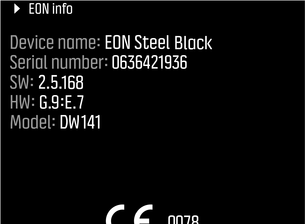

How to access device info
To access Suunto EON Steel Black information:
  1. Keep the middle button pressed to enter the main menu.
  2. Scroll to General with the upper or lower buttons and press the middle button.
  3. Press the middle button to enter About EON.
  4. Scroll to EON info, press the middle button to enter. You can check device software version, serial number, etc. there.
  5. Scroll with the lower button to see all information.
  6. Keep the middle button pressed to go back and exit from the menu.
