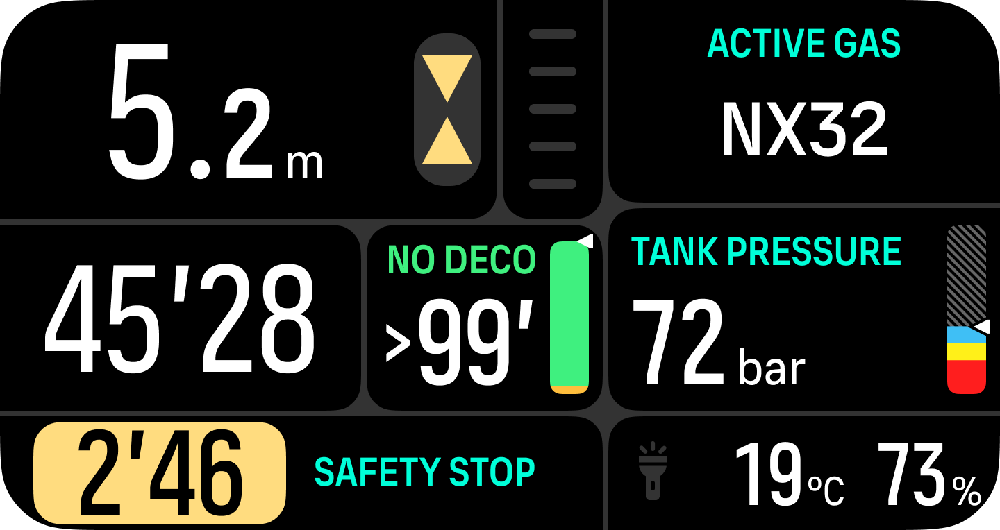

A three (3) minute Safety stop is always recommended for every dive over 10 meters (33 ft). When a safety stop is required, the minimum ceiling value (3 m) appears in the switch window.
The time for a safety stop is calculated when you are between 2.4 and 6 m (7.9 and 20 ft).
This is presented with up and down arrows on the left side of the stop depth value. Safety stop time is shown in minutes and seconds. The preferred safety stop time can be set in the Algorithm menu under Safety stop.

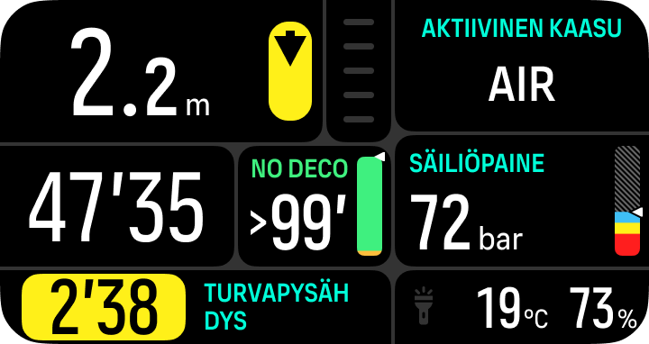

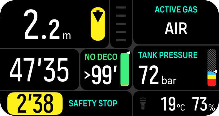

Ascending shallower than 2.4 m will trigger an alarm in the window indicator. Please descend below the 3m ceiling value.
