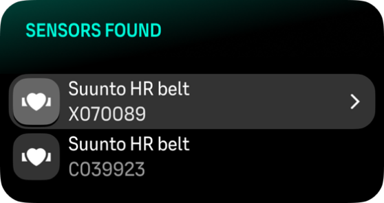

Pairing heart rate sensor
You can pair your Suunto Nautic device with a heart rate belt to track your heart rate during diving.
To pair a heart rate belt:
  1. Go to Control panel > Connectivity.
  2. Select Pair new device.
  3. Select the sensor from list.
    pair hr sensor
NOTE:
You cannot pair anything if airplane mode is on. Turn off airplane mode before pairing.
Once the sensor is paired, your dive computer searches for it as soon as you start your dive.
You can see the full list of paired devices in the dive computer from the settings under Connectivity > Paired devices.
From this list, you can remove (unpair) the device if needed. Select the device you want to remove, and select Forget.
