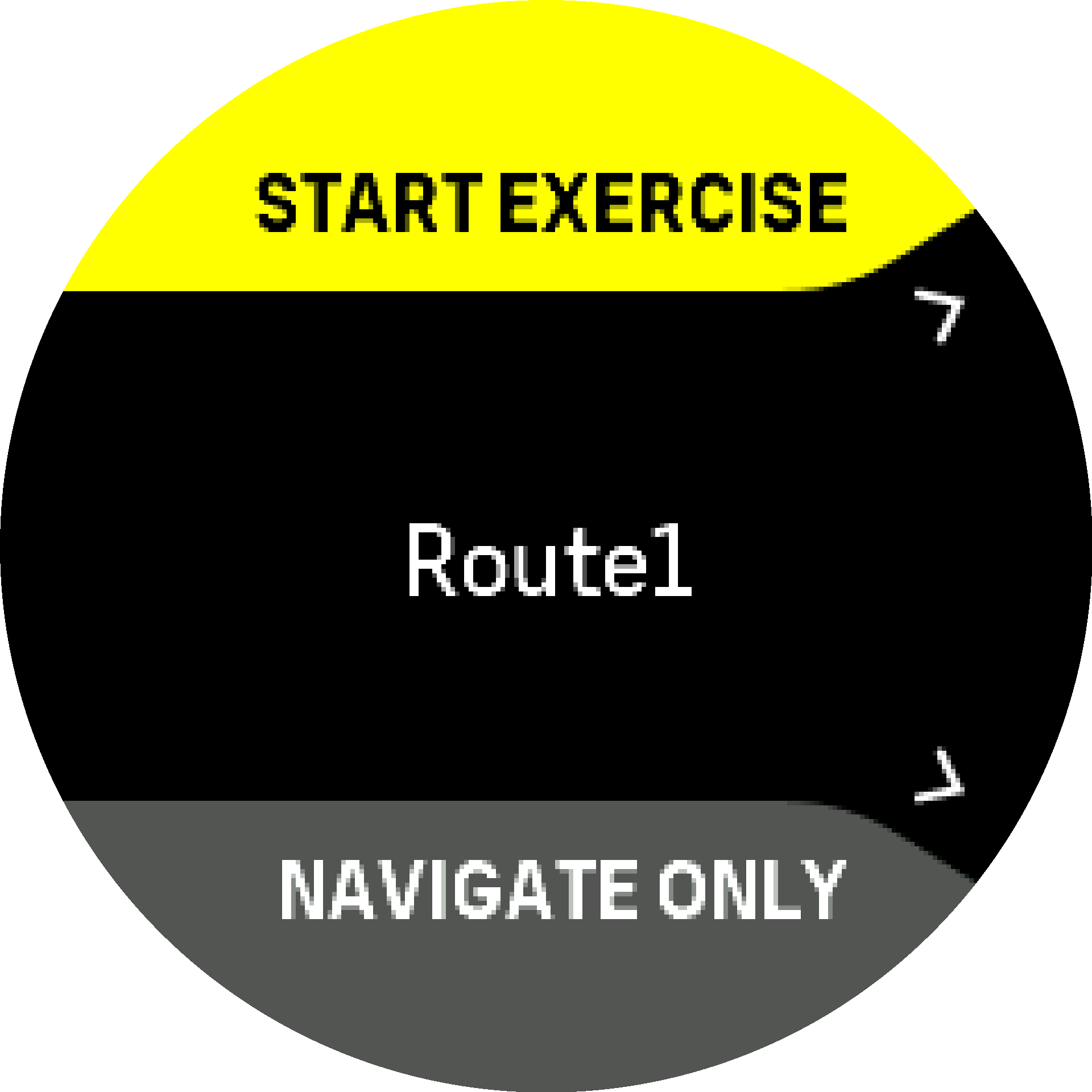

  5. Select the route by pressing the upper button.
  6. Select Start exercise if you want to use the route for exercising or select Navigate only if you only want to navigate the route.
    Routes Exercise S9PP
    NOTE:
    If you only navigate the route, nothing will be saved or logged in Suunto app.

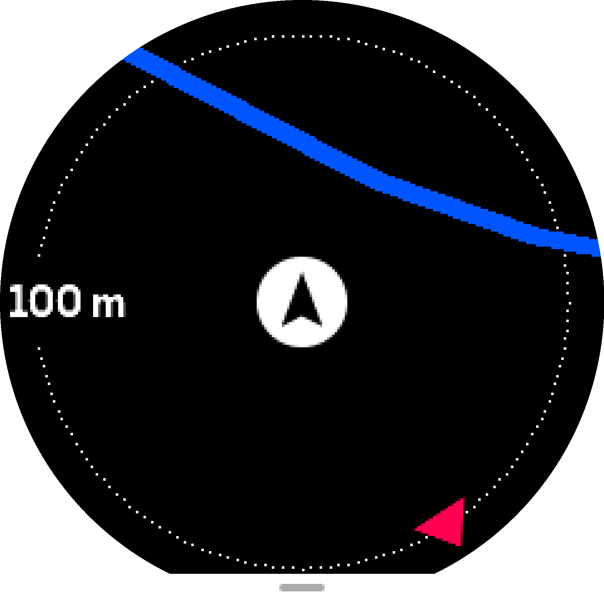

As you navigate a route, your watch helps you stay on the correct path by giving you additional notifications as you progress along the route.
For example, if you go more than 100 m (330 ft) off route, the watch notifies you that you are not on the right track, as well as lets you know when you are back on route.
The guidance field shows the distance to the next waypoint (if there are no waypoints on your route, the distance to the end of the route is shown). Once you approach a waypoint or POI on the route, you get an informative popup showing the distance to the next waypoint or POI.
