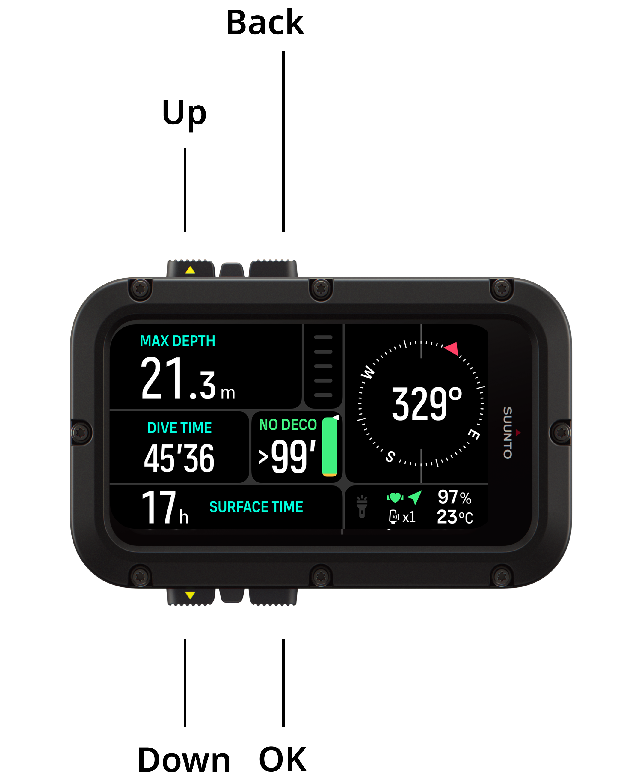

Button functions
Suunto Nautic has four buttons you can use to navigate through displays and features. Short pressing or long pressing them gets you to different functionalities. At the surface and during the dive:
At surfaceDuring dive
Up buttonShort pressAccess widgetsAdjust brightness
Long pressTurn on / off flashlight
Down buttonShort pressAccess Dive settingsAccess dive menu
Long pressButton lock
Back buttonShort pressBack/
Set bearing (If compass in switch window);
Start & Stop Stopwatch (If stopwatch in switch window)
Long pressClear bearing (If compass in switch window);
Reset stopwatch (If stopwatch in switch window)
OK buttonShort pressChange switch window item
