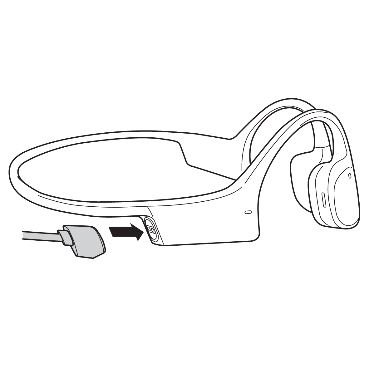

For charging your headphones, use the supplied USB cable.
USB cable
The USB charging cable is included in the product package. For charging the headphones with the cable, connect the magnetic end of the cable to the charging port of the headphones. If the headphones are switched on, they will automatically switch off when the charging starts. While the headphones are charging, the red LED light is on. When the battery is fully charged, the LED light turns white for a minute, then it turns off.
