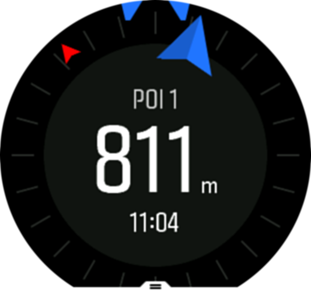

The POI navigation has two views:
  • POI view with direction indicator and distance to the POI

Swipe left or right, or press the middle button, to switch between views.
While in the POI view, tap on the screen to see additional information in the lower row such as altitude difference between current position and POI and estimated time of arrival (ETA) or en route (ETE).
