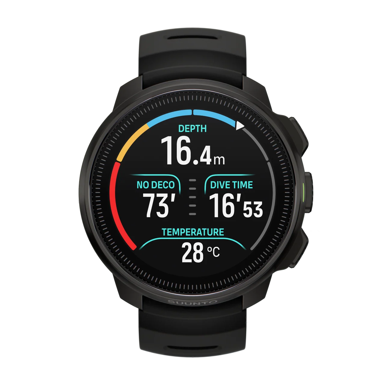

Say you check your computer during a dive and see 73 minutes in the NDL field.
This means your computer estimates you can stay at your current depth for about another 73 minutes and still make your ascent without mandatory decompression stops.

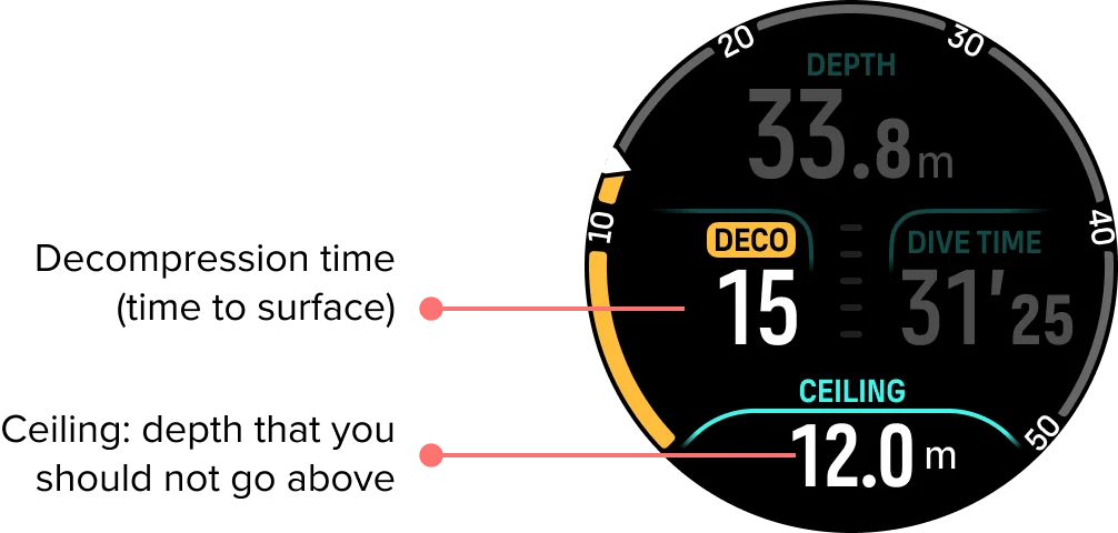

A mandatory decompression stop is a different matter. Once you exceed your NDL and incur a decompression obligation, you must complete stops at the depths specified by your dive computer or decompression plan before continuing your ascent. For example, another diver’s NDL may have reached zero, and their computer now shows a decompression requirement with an estimated ascent time of 8 minutes, including mandatory decompression stops. Those stops are required, every time.

Say you check your dive computer at 18 meters (60 feet) and see that your NDL has reached zero. The display has switched to decompression information and shows, for example, an estimated time to surface of 8 minutes. You have now incurred a decompression obligation, and your ascent requires mandatory decompression stops.
Stay calm. Check your remaining gas supply and your buddy’s location, and let your buddy know your status. Keep your ascent slow and controlled, and resist the urge to rush up to “beat the clock.” Follow the decompression information on your dive computer and complete every indicated decompression stop.
On Suunto Ocean, the official user guide explains that when NDL reaches zero and decompression is required, the NDL field switches to TTS (time to surface) and the computer displays decompression-related information.
