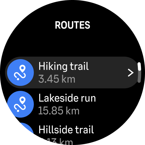

  4. Scroll to Routes and press the crown to open your list of routes.
  5. Scroll to the route you want to navigate to and press the crown.
    routes dilu

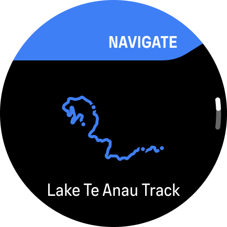

  6. Scroll down for the route details.
  7. Start the navigation by pressing the upper button.
    start navigation

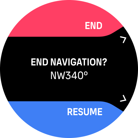

  8. If you want to stop navigating, press the upper button to open navigation options and select the End navigation option. Confirm ending the navigation by pressing the upper button.
    end navigation

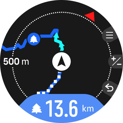

While you are on the route navigation display, you have the following options:
  • turn the crown to go to the altitude view
  • press the crown to go to the map view where you can zoom in and out by turning the crown
  • press the upper button to open navigation options (for example, check route details, select another route to navigate, save POIs and turn on and off breadcrumb view and POI display)
Navigation guidance
As you navigate a route, your watch helps you stay on the correct path by giving you additional data in the navigation guidance field at the bottom of the screen and sending you notifications as you progress along the route.
For example, if you go more than 100 m (330 ft) off route, the watch notifies you that you are not on the right track, as well as lets you know when you are back on route.
The guidance field shows the distance to the next waypoint (if there are no waypoints on your route, the distance to the end of the route is shown). Once you approach a waypoint or POI on the route, you get an informative popup showing the distance to the next waypoint or POI.
navi guidance
