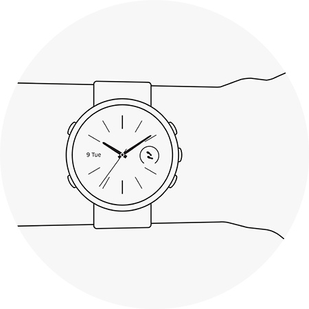

Wear your Suunto watch at least one finger above your wrist bone and make sure the watch is snug on your wrist. Your watch should always maintain contact with your skin so that you can't see the light shining from the sensor.
During exercise
Test the fit – the key is to wear the watch as high up on your wrist as possible and to prevent it from sliding down during exercise. A good indicator is to wear it about two fingers above your wrist bone. Again, make sure you wear the watch tight and evenly against the skin, however not too tight to cut off blood circulation.
It takes time and practice to figure out the best fit for your wrist with a specific watch model. Try several and compare the results.
Too loose
Wear your watch so that you are able to perform regular hand gestures and movements without feeling the watch too tight. Make sure you don't see the LED lights.
 Just right
It takes time and practice to figure out the best fit for your wrist with a specific watch model. Try several fits during sport and while resting and compare the results. Happy training!
