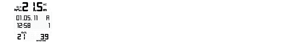

  1. Main page
logbook page1
  • maximum depth
  • date of dive
  • type of dive (indicated by first letter of dive mode, e.g. A for Air mode)
  • dive start time
  • dive number – from oldest to newest
  • gas percentage(s) of the first used gas mix
  • total dive time (in minutes in all modes)

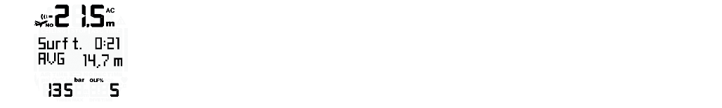

  • Surface time and warnings page
logbook page2
  • maximum depth
  • surface time after previous dive
  • average depth
  • consumed pressure (if enabled)
  • warnings
  • OLF% (if applicable)

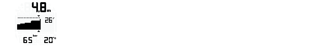

  • Dive profile graph
logbook page3
  • water temperature
  • tank pressure (if enabled)
  • gas changes
  • setpoint changes
  • depth/time profile of the dive
Press UP to step through the dive profile graph or keep UP pressed to auto-scroll.
The dive profile graph shows point by point dive information such as depth, compass heading, decompression info, ceiling and ascent time.
