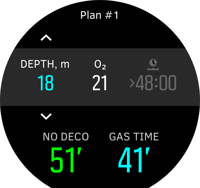

Planning the first dive in a series
  1. Edit depth and mixture in View planner.
  2. As an example, enter 18 meters, use a mixture of 21% oxygen, and you will see the following:
    Dive planner D5 1
    In this example, the calculated values are:
    1. Dive number in the dive series: 1
    2. Available no decompression time: 51 minutes
    3. Remaining gas time: 41 minutes

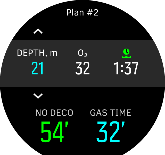

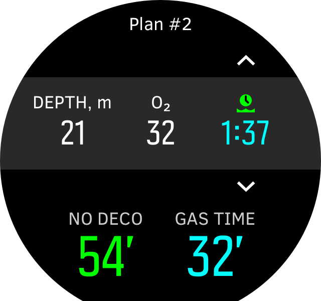

Planning additional dives
The dive planner allows you to adjust surface time in 10-minute increments. 48:00 hours is the maximum value to be set.
In the example below, the surface time before the second dive is 1 hour 37 minutes. Adjust surface time to see how it impacts no decompression time.
Dive planner D5 2
