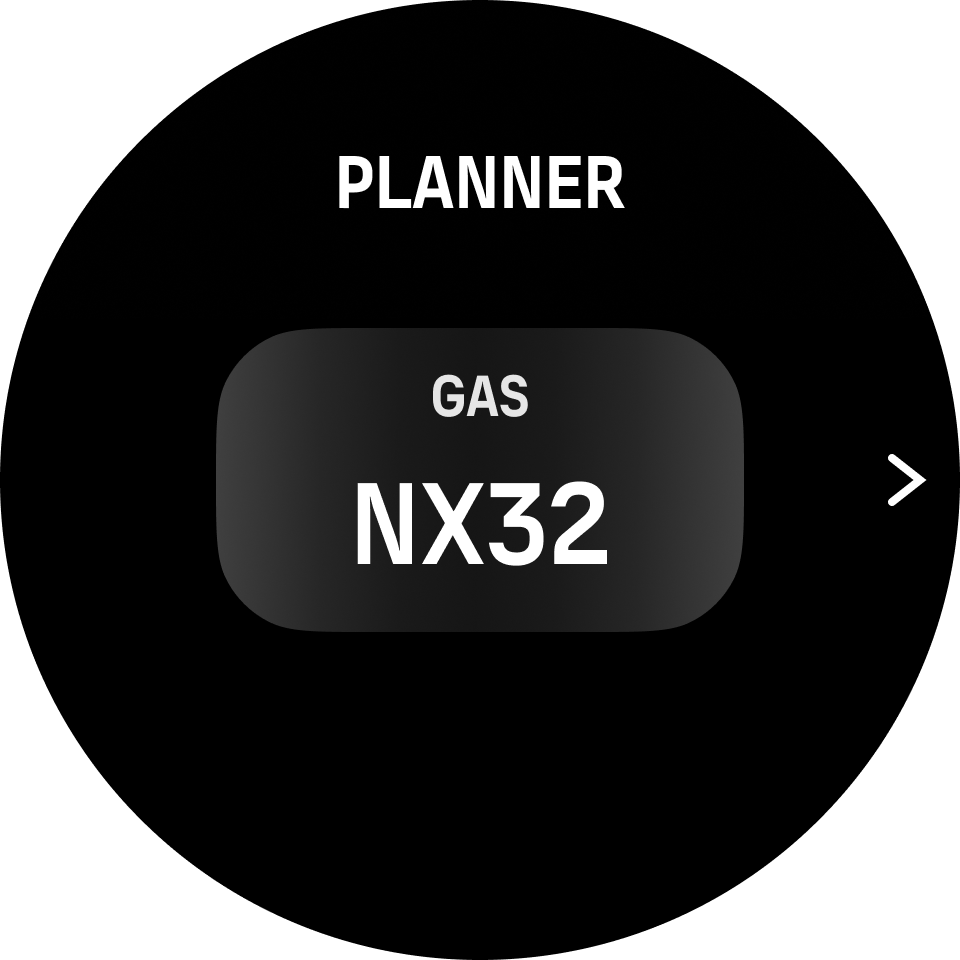

Before you start planning your next dive in the Planner menu, set the following:
  • the active gas planned for the dive
  • algorithm settings: conservatism and altitude settings
The planner displays the active gas defined for the dive mode. You can modify the gas settings under the Gases menu (see 5. Gases).
planner 1

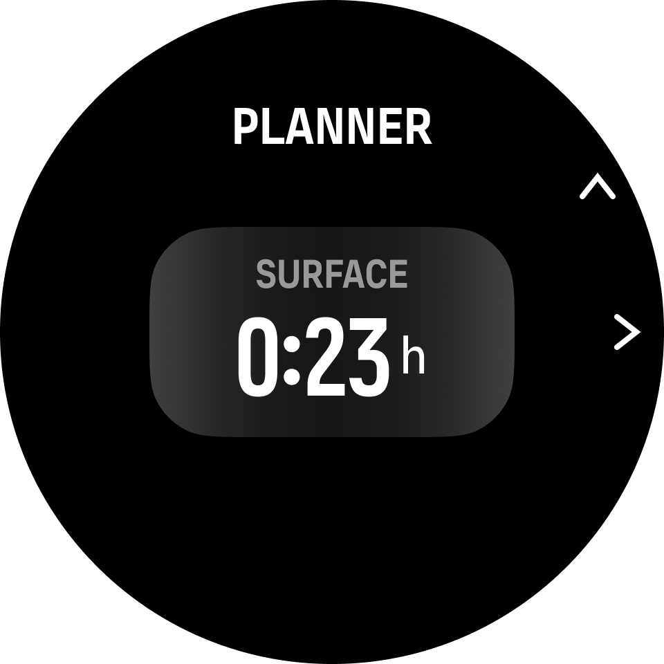

The surface interval is calculated automatically from the end of the previous dive. Use the upper and lower buttons to adjust the value in 10-minute increments to reflect the planned surface interval. The maximum value is 48 hours.
planner 2

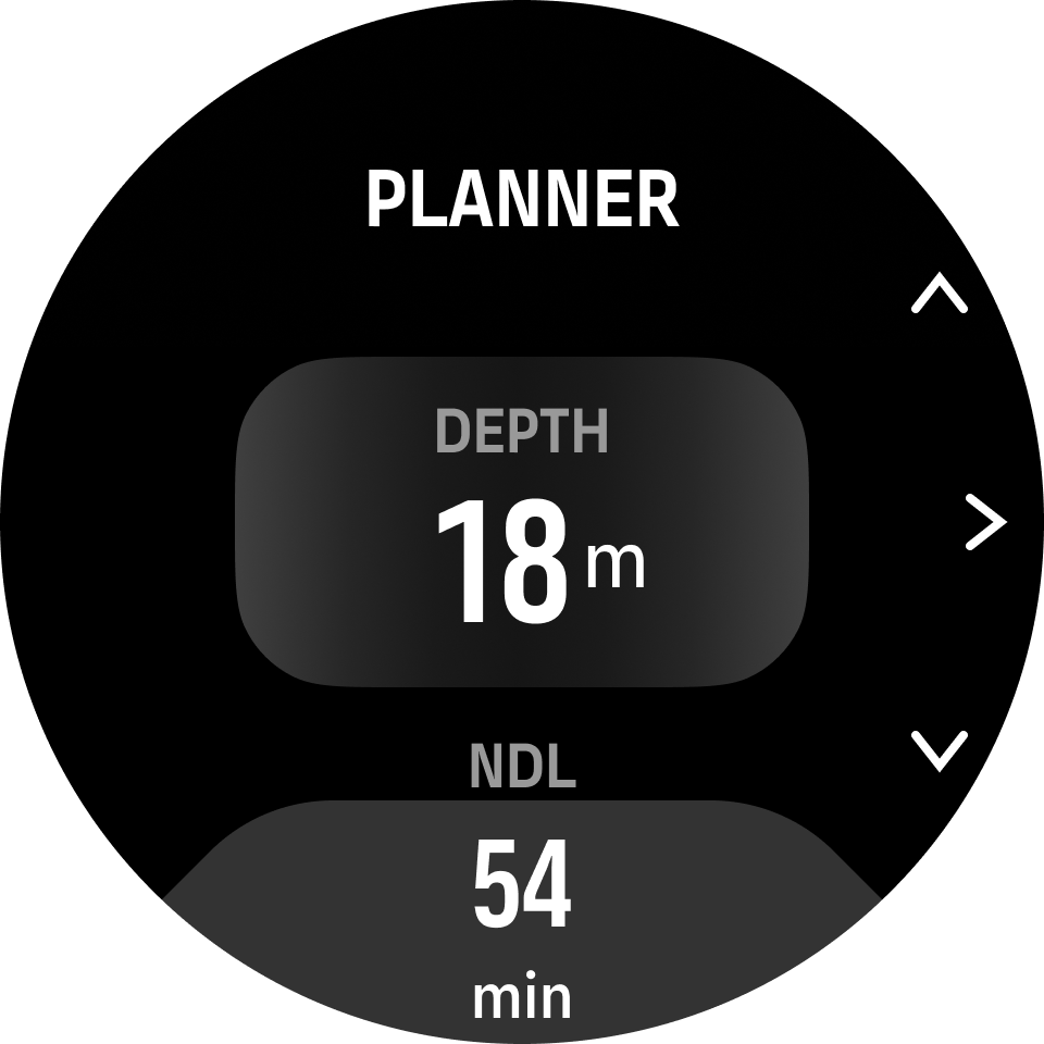

Use the upper and lower buttons to adjust the planned depth. You can see the NDL time for the specific depth at the bottom of the screen.
planner 3

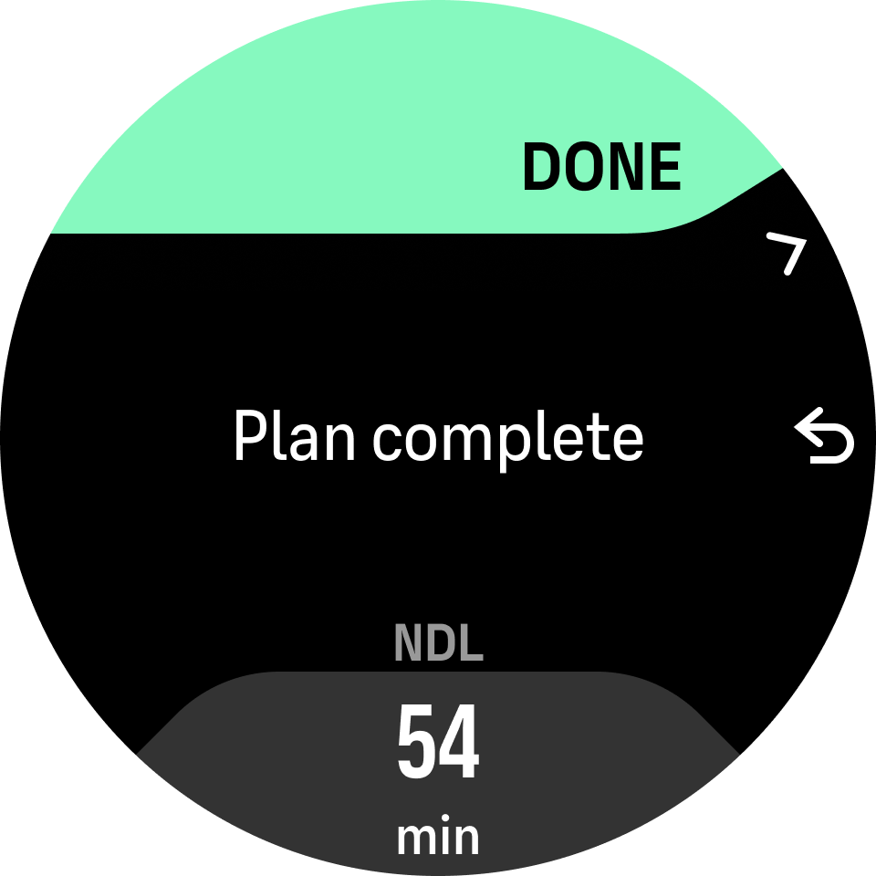

Press the upper button to return to the pre-dive menu or press the middle button to return to the beginning of the planner.
planner 4
