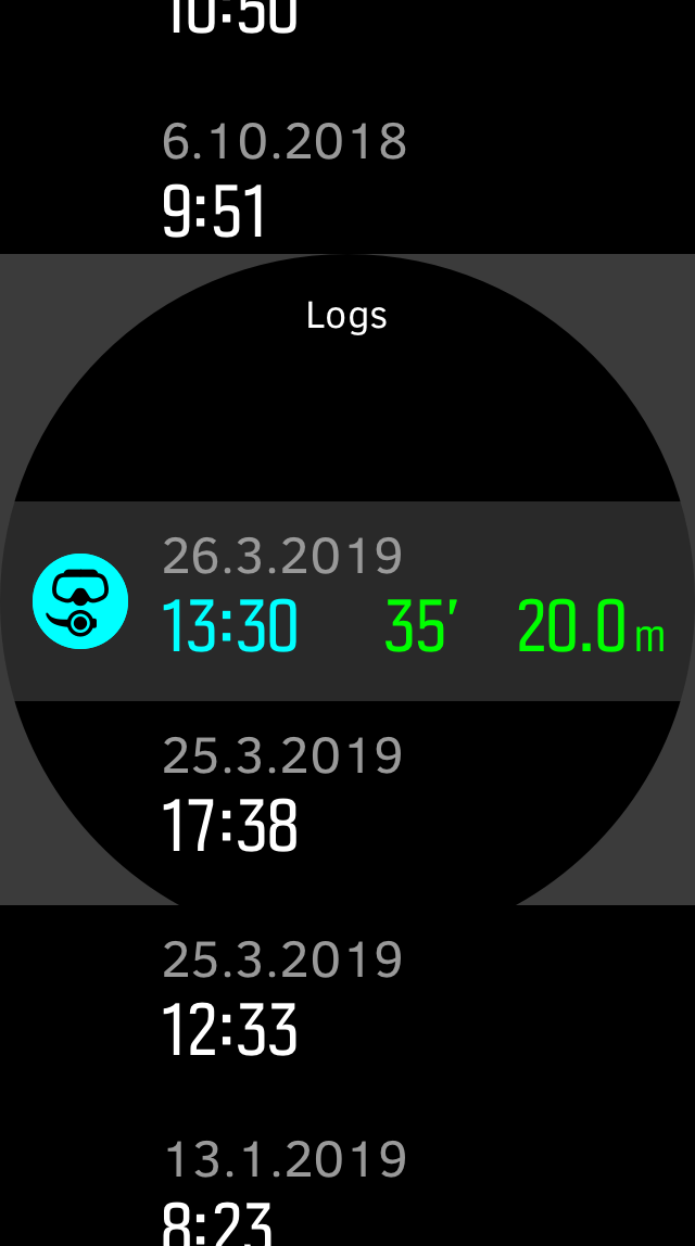

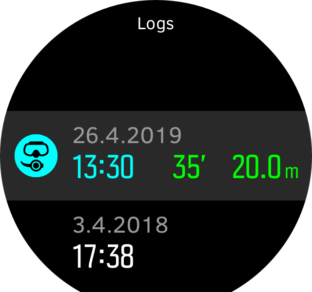

Dive logs can be found under Logs. They are listed by date and time, and each entry listing shows the max. depth and dive time of the log.
Dive log details and profile can be browsed by scrolling through the logs with the upper or the lower button and selecting a log with the middle button.
