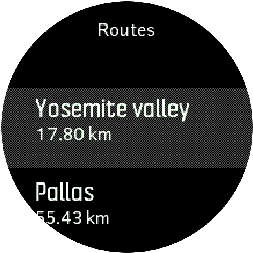

  3. Scroll to Routes and press the middle button to open your list of routes.
    Routes list Trainer
  4. Scroll to the route you want to navigate to and press the middle button.
    Routes Exercise S5
  5. Select Start exercise if you want to use the route for exercising or select Navigate only if you only want to navigate the route.

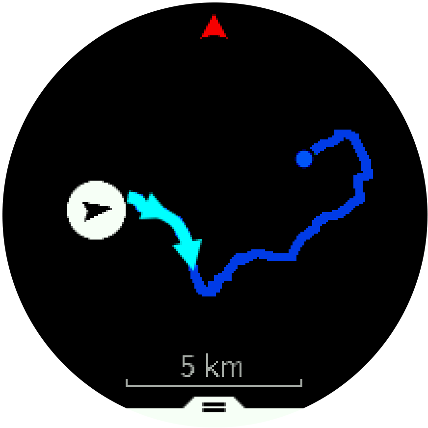

    Route overview S5
In the detailed view, zoom in and out by keeping the middle button pressed. Adjust the zoom level with the upper right and lower right buttons.

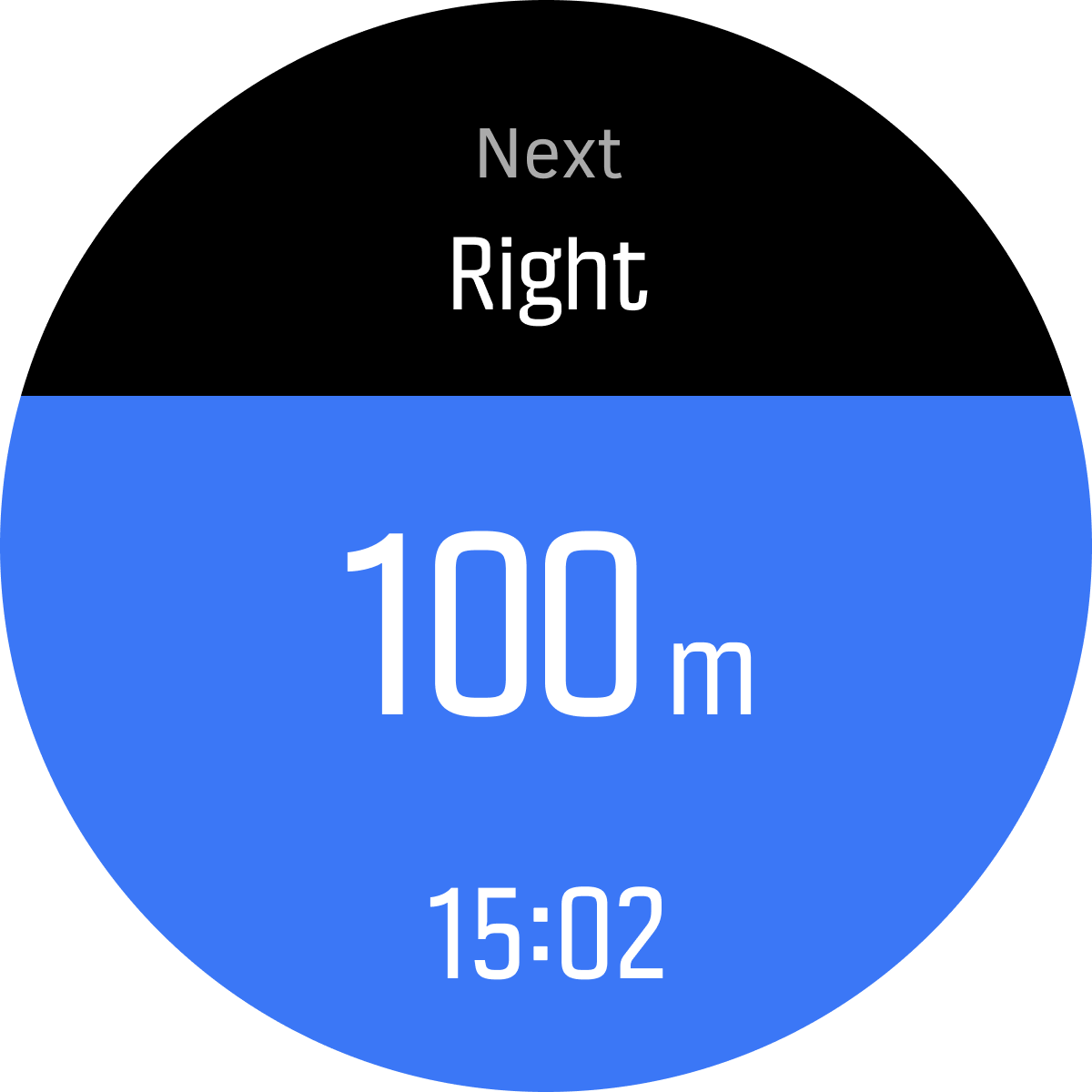

Turn-by-turn navigation
When creating routes in Suunto app, you can choose to activate turn-by-turn instructions. When the route is transferred to your watch and used for navigation, it will give you turn-by-turn instructions with a sound alert and information on which way to turn.

If you are a Komoot member, you can find or plan routes with Komoot and sync these to your Suunto 5 Peak via Suunto app. In addition, your exercises recorded with your watch will automatically be synchronized to Komoot.
When using route navigation with your Suunto 5 Peak together with routes from Komoot, your watch will give you turn-by-turn instructions with a sound alert and a text on which way to turn.

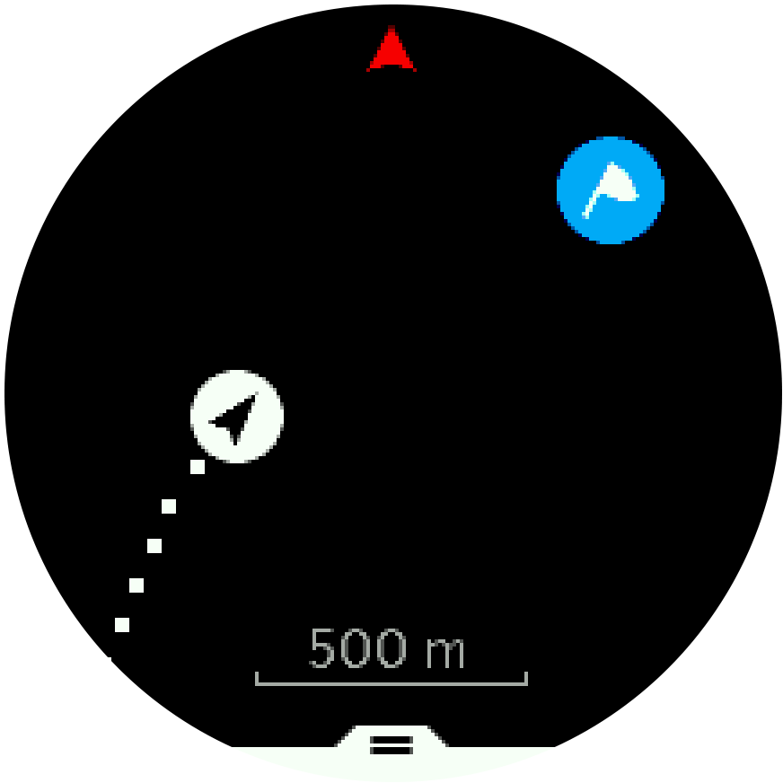

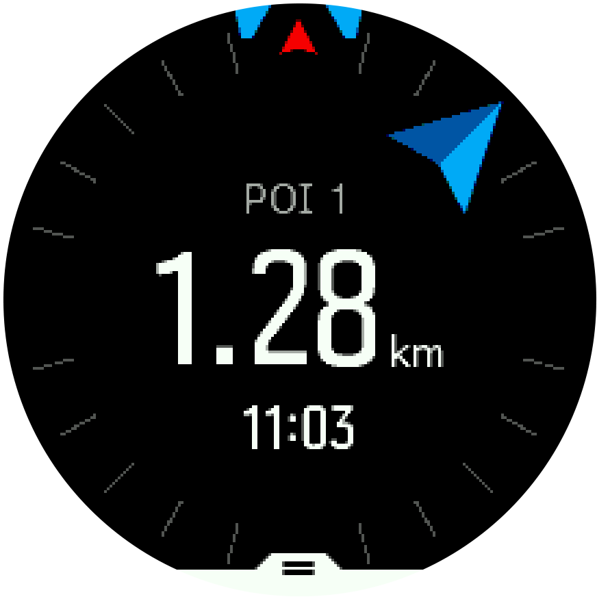

While you are moving, the POI navigation has two views:
  • POI view with direction indicator and distance to the POI
    POI detail view Trainer
  • map view showing your current location relative to the POI and your breadcrumb trail (the track you have traveled)
    POI map view Trainer
Press the middle button to switch between views. If you stop moving, the watch cannot determine which direction you are going based on GPS.
While in the POI view, tap on the screen to see additional information in the lower row such as altitude difference between current position and POI and estimated time of arrival (ETA) or en route (ETE).
In the map view, other POIs nearby are shown in gray. Press the upper left button to switch between the overview map and a more detailed view. In the detailed view, you adjust the zoom level by pressing the middle button and then zooming in and out with the upper and lower buttons.
