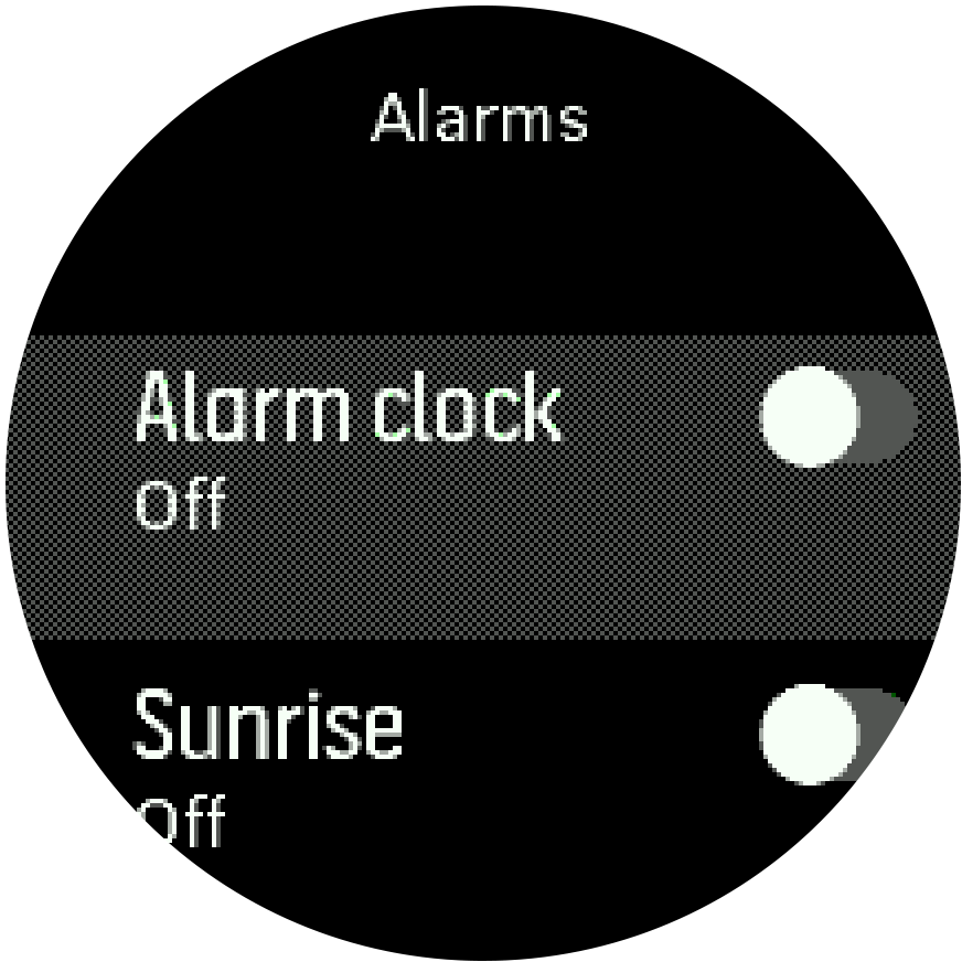

To set sunset/sunrise alarms:
- Press the middle button to open the shortcut menu.
- Scroll down to Alarms and enter by pressing the middle button.
Scroll to the alarm that you want to set and select by pressing the middle button.
- Set the desired hours prior to sunrise/sunset by scrolling up/down with the upper and lower buttons and confirming with the middle button.
Set minutes in the same way.
- Press the middle button to confirm and exit.
