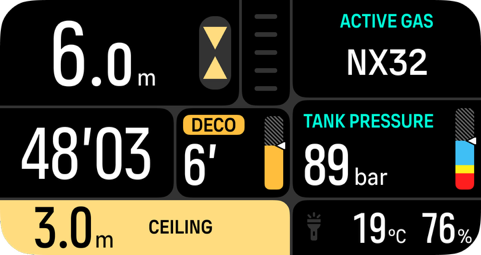

If diving with a Stepped deco profile, a timer will start the countdown when entering the decompression window and the ceiling is the same for a specific time and then moves upwards 3 m (9.8 ft) at a time.
Inside the decompression window (Stepped profile):

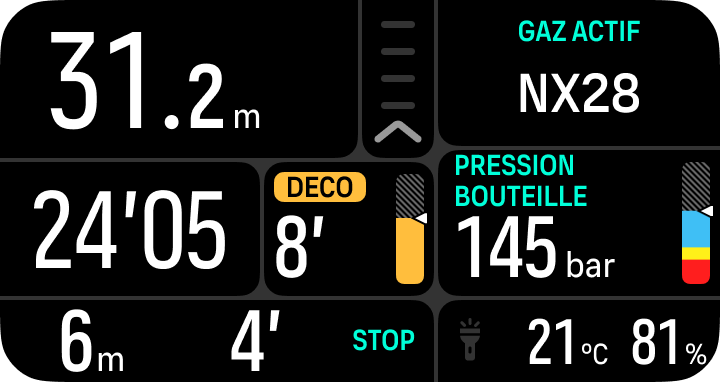

In the Continuous ascent mode, the ceiling is constantly decreasing while you are near the ceiling depth, providing continuous decompression with optimum ascent time.
Inside the decompression window (Continuous profile):
