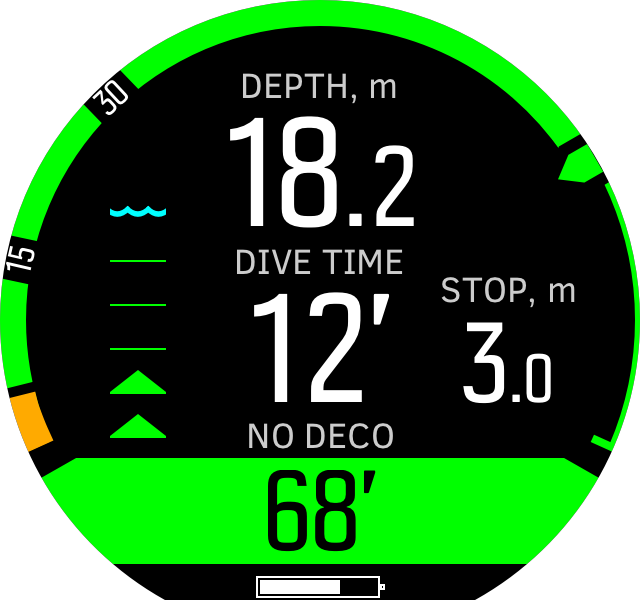

Air/Nitrox mode
By default, Air/Nitrox mode is for diving with regular air and diving with oxygen enriched gas mixtures.
Diving with nitrox gas mixture allows you to increase bottom times or reduce the risk of decompression illness. Suunto D5 provides you with information to adjust your dive and stay within safe limits.
When diving with a nitrox gas mixture, both the percentage of oxygen in your tank and the oxygen partial pressure limit must be entered into Suunto D5. This ensures correct nitrogen and oxygen calculations and the correct maximum operating depth (MOD), which is based on your entered values. The default oxygen percentage (O2%) setting is 21% (air) and oxygen partial pressure (pO2) setting is 1.6 bar (23 psi).
NOTE:
When diving with a nitrox gas mixture, Suunto recommends changing the partial pressure to 1.4 bar (20 psi).
Air/Nitrox mode has four views:
  • No deco - The arch shows the no decompression time.

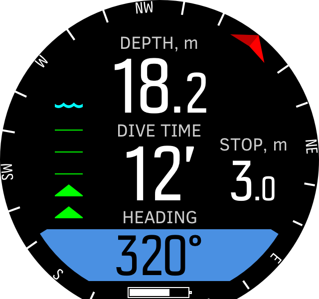

  • Compass
    airnitrox compass

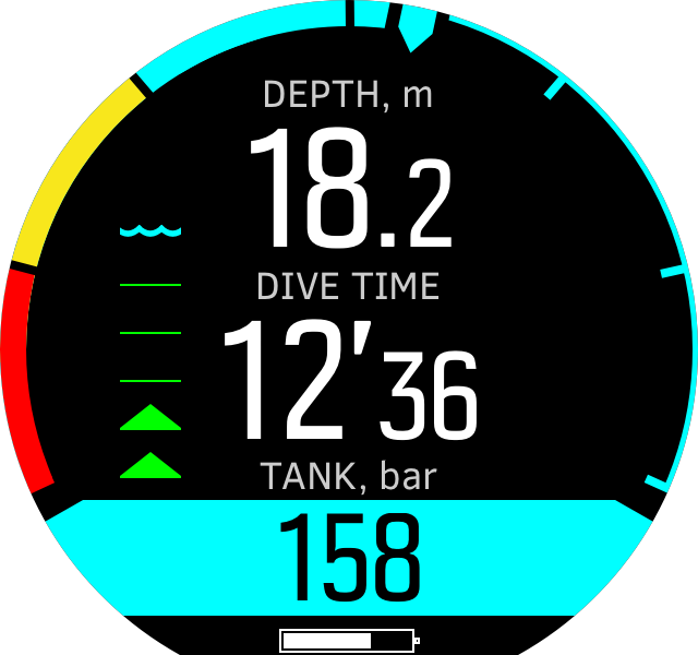

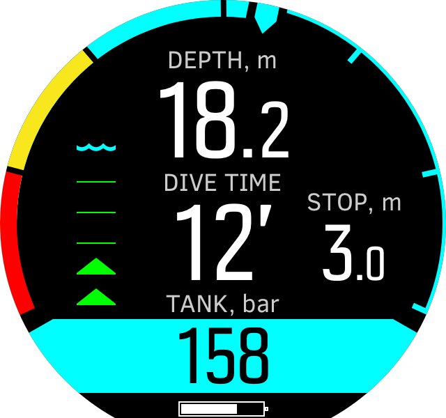

  • Tank pressure - For more information on what is shown on the display, see Tank pressure.
    airnitrox tank pressure

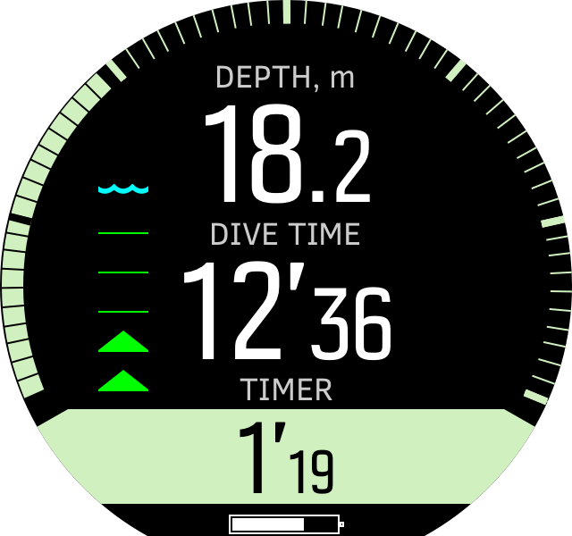

  • Timer (visible after customizing with Suunto app)
    airnitrox timer

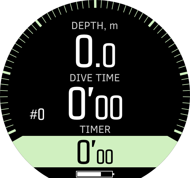

Gauge mode
Use Suunto D5 as a bottom timer with Gauge mode.
The timer in the center of the display shows dive time in minutes and seconds and activates at the start of the dive.
Gauge mode is a bottom timer only. It does not use any decompression algorithm, thus it does not include decompression information or calculations.

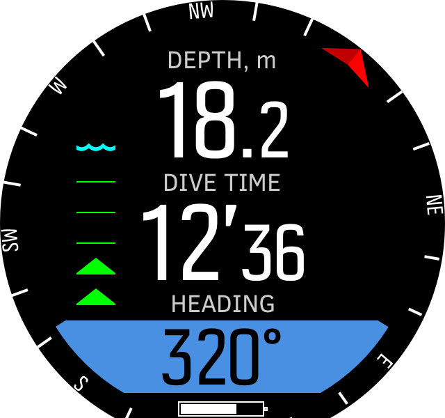

  • Compass
    Gauge compass D5

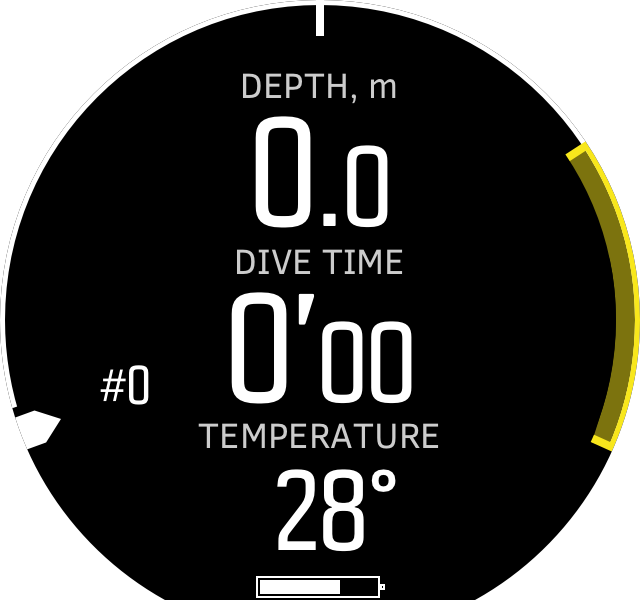

Freedive mode
With Free mode, Suunto D5 can be used as a freediving instrument.
Go to Main menu » Dive settings » Mode to activate Free mode. Suunto D5 will restart to change mode. When you activate Free mode, the display shows you data in white color. Depth is indicated in the unit you set (see How to set language and unit), dive time in minutes and seconds in the center of the display. Temperature information is at the bottom of the display. With the lower button you can change the window at the bottom of the display.
The freedive starts at 1.2 m (4 ft) with water contact or 3.0 m (10 ft) without water contact and ends when your depth is less than 0.9 m (3 ft) with water contact or 3.0 m (10 ft) without water contact. For more information on the water contact sensor, see Water contacts.
Freedive mode has three views by default:
  • Time
  • Depth
  • Compass
A fourth view is available after customization in the Suunto app:
  • Timer
You can change the views with short pressing the middle button.
Time
Before dives:
Freedive time before dive D5
During dives:
Freedive time during dive D5
Depth
It is the default view. The white arrow on the left side of the arch moves according to the depth. The yellow arch shows the depth between the max depth (defined by Depth notify 5) and the next deepest active depth notification.
Before dives:
Freedive depth before dive D5
During dives:
Freedive depth during dives D5

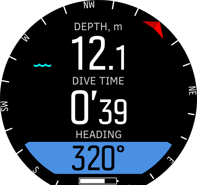

Compass
Before dives:
Freedive sompass before dives D5
During dives:
Freedive compass during dives D5
Timer
This view is available only after customization in Suunto app.
Before dives:
Freedive timer before dives D5
During dives:
Freedive timer during dives D5

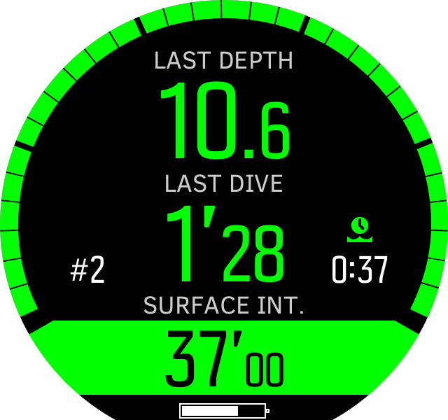

On the surface after freediving
Free mode surface depth view D5
When you are on the surface after freediving, the data on the display turns green. You can see your last depth, the time of your last dive, and the number of dives you have done (white number with a hashtag).

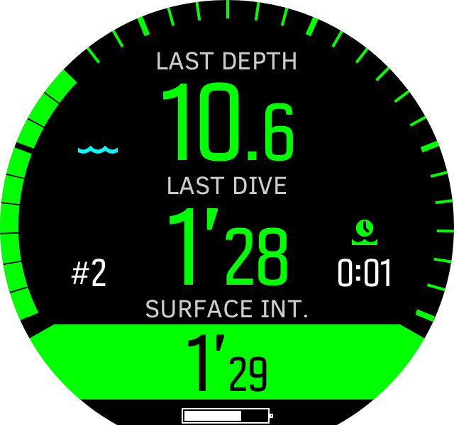

Surface notify
In Timer view the surface interval time is being counted in minutes and seconds at the bottom of the display in a green field until the value you set in Main menu » Dive settings » NOTIFICATIONS » Surface notify.
Free mode surface interval D5
If Surface notify is off, the surface interval counter runs for 4 hours, after that, or after the previously set surface interval time has passed, the counter disappears from the display. Your Suunto D5 will show the following data:

Surface timer
While freediving, you can use the surface timer to help you prepare yourself for your next dive. Suunto D5 starts the counter as soon as you reach 0.9 m (3 ft).
