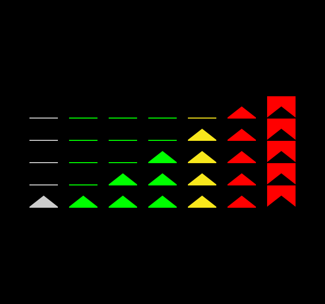

During a dive, the bar on the left indicates ascent rate. One bar step corresponds to 2 m (6.6 ft) per minute.
The bar is also color coded:
  • Green indicates ascent rate is ok, less than 8 m (26 ft) per minute
  • Yellow indicates ascent rate is moderately high, 8-10 m (26-33 ft) per minute
  • Red indicates ascent rate is too high, over 10 m (33 ft) per minute
p13-ascend
When maximum allowed ascent rate is exceeded for five seconds, an alarm is generated. Ascent rate violations result in longer safety stop times and mandatory safety stops.
