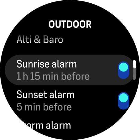

To set sunset/sunrise alarms:
  1. From watch face, keep the crown pressed to enter Settings.
  2. Scroll to Outdoor and enter the menu by tapping on its name or pressing the middle button.
  3. Scroll to the alarm that you want to set and select it.

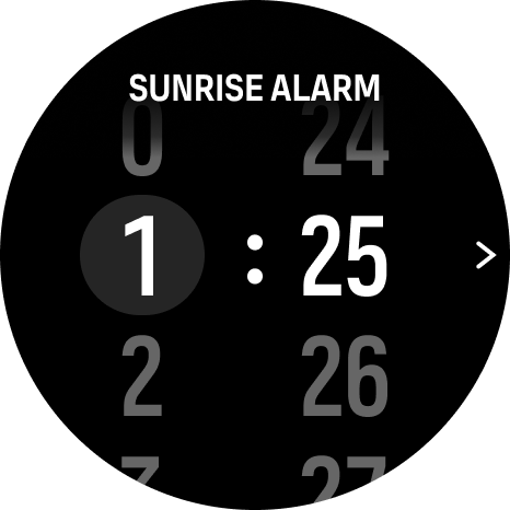

    sun alarm
  4. Set the desired hours and minutes prior to sunrise/sunset by scrolling up and down with the crown or by swiping up and down on the screen and confirming with the middle button.
    alarm time
  5. Press the middle button to confirm and exit.

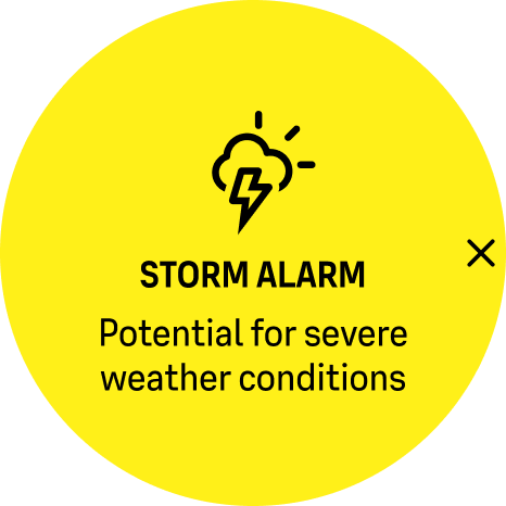

Storm alarm
A significant drop in barometric pressure typically means a storm is coming and you should take cover. When the storm alarm is active, Suunto Run sounds an alarm and displays a storm symbol when the pressure drops 4 hPa (0.12 inHg) or more during a 3-hour period.
To activate the storm alarm:
  2. Scroll to Outdoor and enter the menu by tapping on its name or pressing the crown.
  3. Scroll to Storm alarm and toggle it on/off by tapping on its name or pressing the crown.
When a storm alarm sounds, pressing any button ends the alarm. If no button is pressed, the alarm notification lasts for one minute. The storm symbol remains on the display until the weather conditions stabilize (pressure drop slows down).
