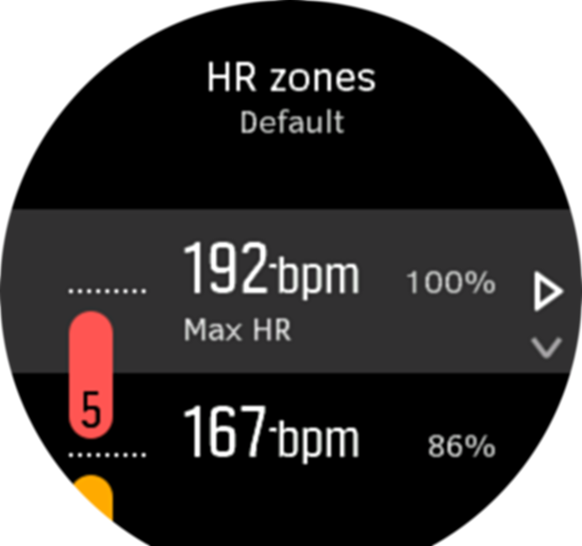

Set max HR
Set your maximum HR from the settings under Training » Intensity zones » Default zones.
  1. Tap the max HR (highest value, bpm) or press the middle button.
  2. Select your new max HR by swiping up or down or by pressing the upper right or lower right buttons.
Default Max HR
  1. Tap your selection or press the middle button.
  2. To exit the HR zones view, swipe right or keep the middle button pressed.

Set default HR zones
Set your default HR zones from the settings under Training » Intensity zones » Default zones.
  1. Scroll up/down and tap or press the middle button when the HR zone you want to change is highlighted.
  2. Select your new HR zone by swiping up or down or by pressing the upper right or lower right buttons.
Default HR zone
    NOTE:
    Selecting Reset in the HR zones view will reset the HR zones to the default value.

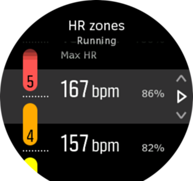

Set activity specific HR zones
Set your activity specific HR zones from the settings under Training » Intensity zones » Advanced zones.
  1. Tap the activity (running or cycling) that you want to edit or press the middle button when the activity is highlighted.
  2. Press the middle button to toggle the HR zones on.
  3. Scroll up/down and tap or press the middle button when the HR zone you want to change is highlighted.
  4. Select your new HR zone by swiping up or down or by pressing the upper right or lower right buttons.
Advanced HR Zone
