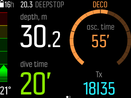

Below is a typical decompression dive view showing ascent time and the first required deep stop at 20.3 meters:
Asc Time Core
Suunto EON Core shows the ceiling value always from the deepest of these stops. Deep stop and safety stop ceilings are always at constant depth when you are at the stop. Safety stop and decompression stop times are counted down in minutes, deep stop time is shown in minutes and seconds.

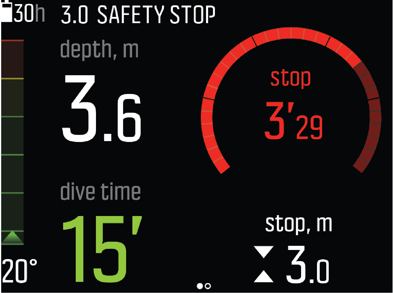

The below display shows that the ceiling depth is set to 3.0 m and the diver is at 3.6 m. The white arrows indicate again that the diver is inside the decompression window. 3' 29 is shown in red as the time for a compulsory stop:
