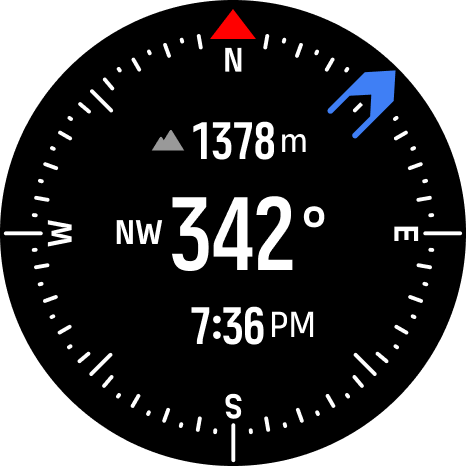

Bearing navigation is a feature that you can use outdoors to follow the target path for a location you see or have found on a map. You can use this feature stand alone as a compass or together with a paper map.
bearing dilu
To use bearing navigation without exercising:
  1. Scroll to Navigation by swiping up or turning the crown from watch face.
  2. Press the upper button to open navigation options.
  3. Select Navigation target.
  4. If needed, calibrate the compass by following the on-screen instructions.
  5. Point the blue arrow on the screen towards your target location and press the middle button.
  6. Follow the blue arrow to the location.
  7. Press the upper button and select End navigation to end the navigation.
