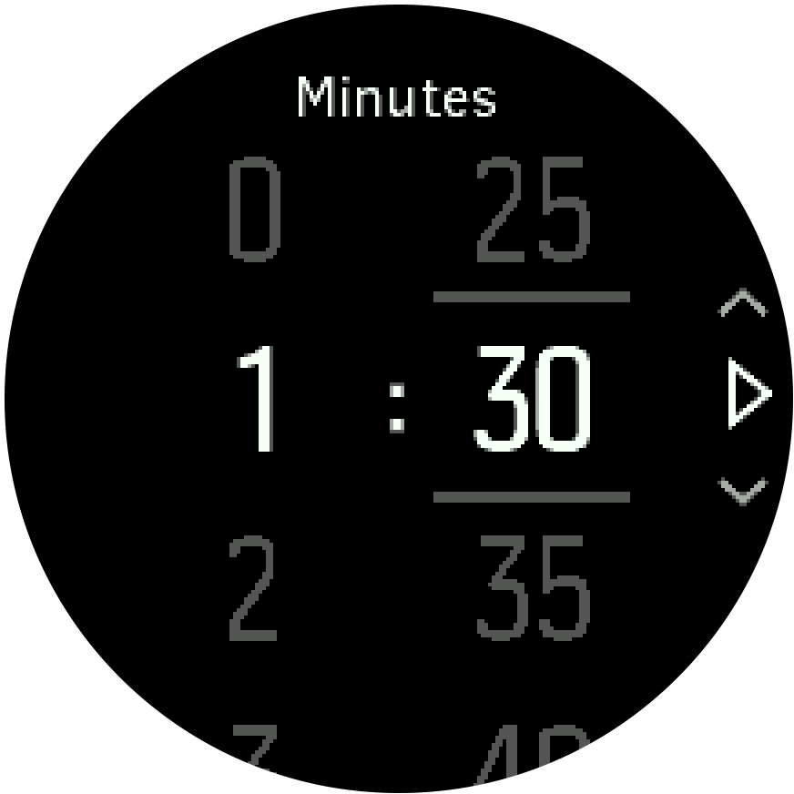

  4. Set the desired hours prior to sunrise/sunset by scrolling up/down with the upper and lower buttons and confirming with the middle button.
  5. Set minutes in the same way.
    Time before sunset sunrise Spartan Trainer
  6. Press the middle button to confirm and exit.
