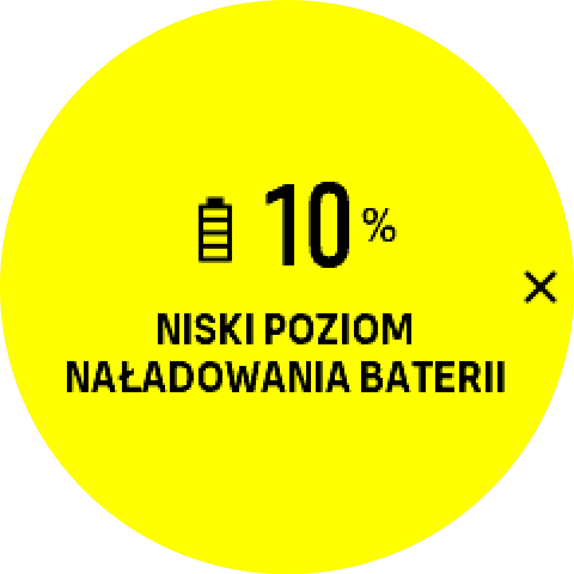

Battery notifications
In addition to the battery modes, your watch uses smart reminders to help you ensure you have enough battery life for your next adventure. Some reminders are preemptive based on, for example, your activity history. You also get notified, for example, when the watch notices you are running low on battery while recording an activity. It will automatically suggest changing to a different battery mode.
Your watch will alert you once when the battery is at 20% and again at 10%.
Battery Warning S9PP
