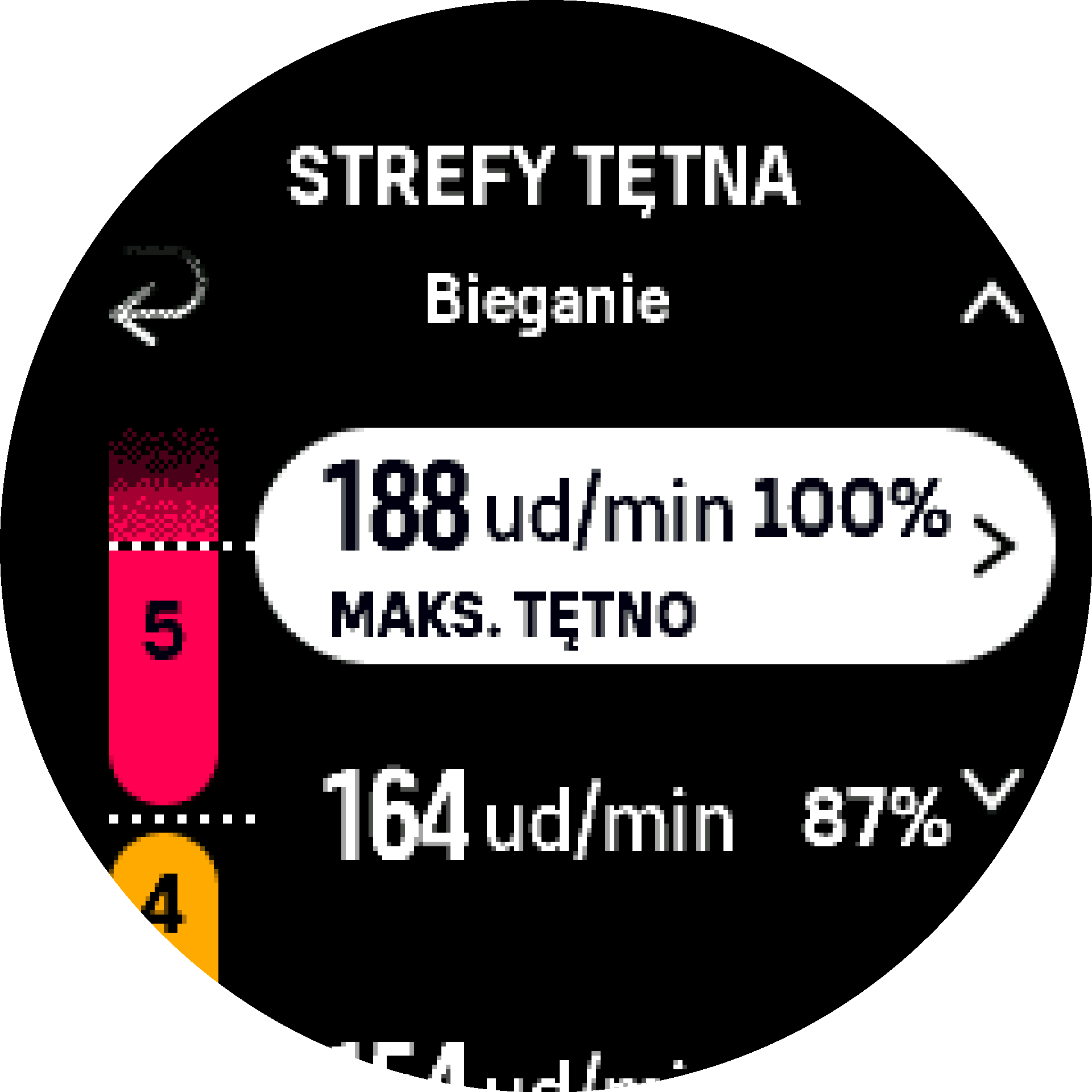

Heart rate zones
Heart rate zones are defined as percentage ranges based on your maximum heart rate (max HR).
By default, your max HR is calculated using the standard equation: 220 - your age. If you know your exact max HR, you should adjust the default value accordingly.
Suunto 9 Peak Pro has default and activity-specific HR zones. The default zones can be used for all activities, but for more advanced training, you can use specific HR zones for running and cycling activities.

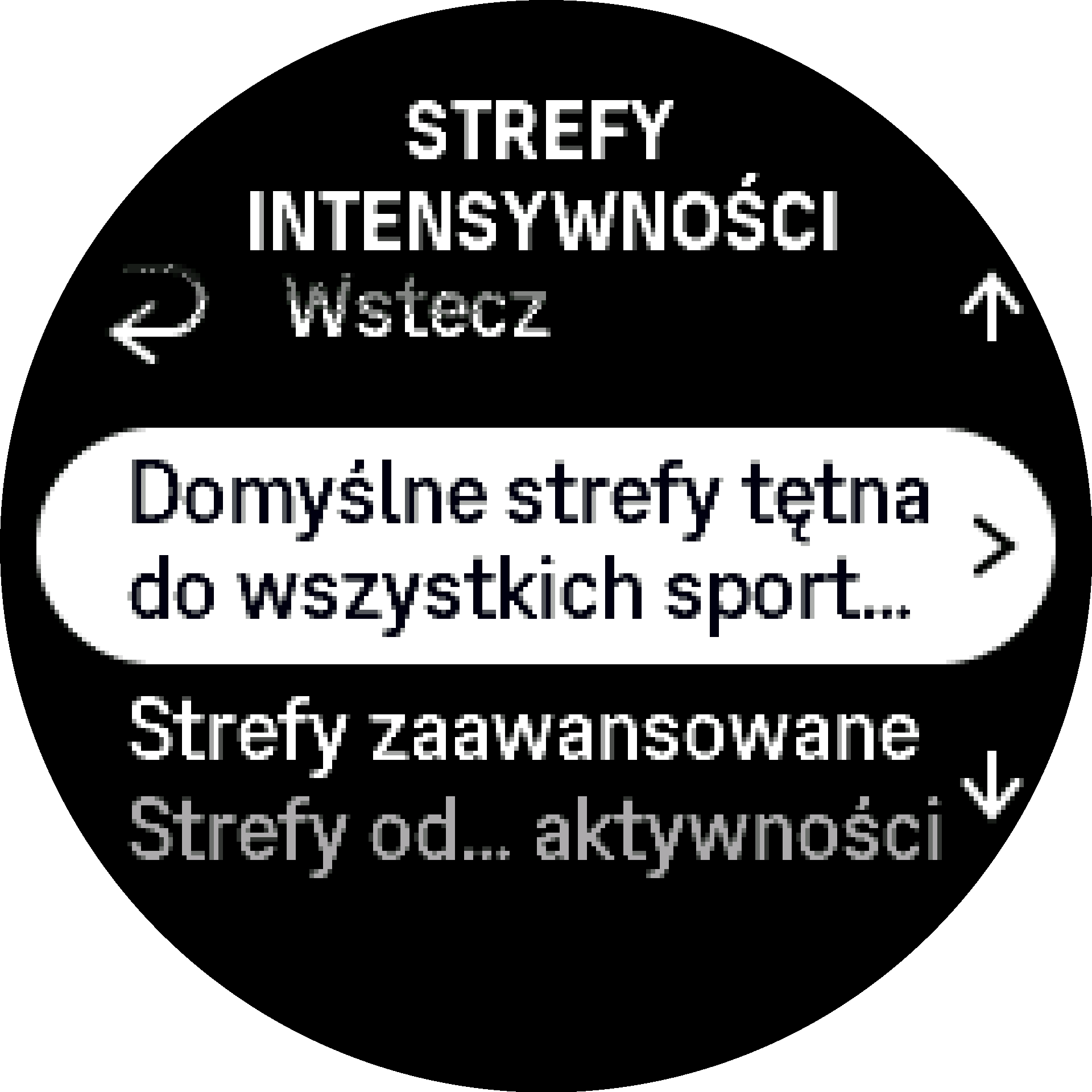

Set max HR
Set your maximum HR from the settings under Training » Intensity zones » Default HR zones for all sports.
  1. Tap the max HR (highest value, bpm) or press the middle button.
  2. Select your new max HR by swiping up or down or by pressing the upper or lower buttons.
    Default Max HR S9PP
  3. Tap your selection or press the middle button.
  4. To exit the HR zones view, swipe right or keep the middle button pressed.
NOTE:
You can also set your maximum HR from the settings under General » Personal.

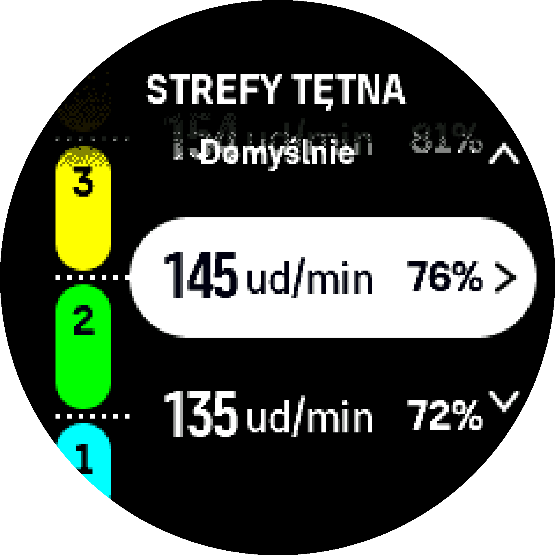

Set default HR zones
Set your default HR zones from the settings under Training » Intensity zones » Default HR zones for all sports.
hr zones item
  1. Scroll up/down and tap or press the middle button when the HR zone you want to change is highlighted.
  2. Select your new HR zone by swiping up or down or by pressing the upper or lower buttons.
    Default HR zone S9PP
    NOTE:
    Selecting Reset in the HR zones view will reset the HR zones to the default value.
Set activity specific HR zones
Set your activity specific HR zones from the settings under Training » Intensity zones » Advanced zones.

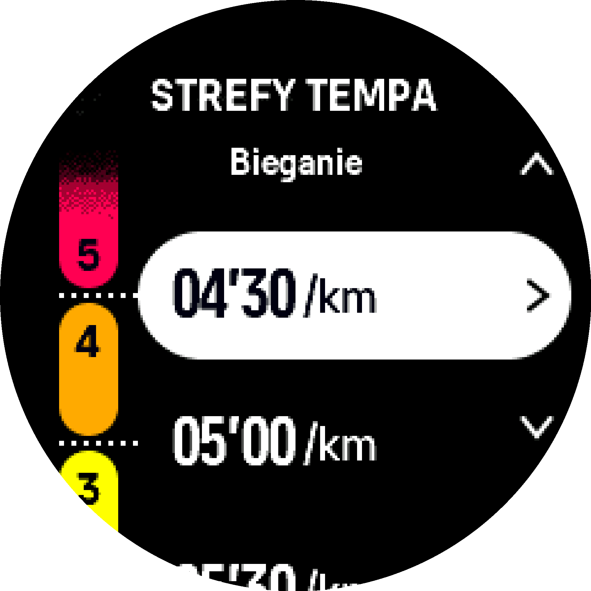

Pace zones
Pace zones work just like HR zones but the intensity of your training is based on your pace instead of your heart rate. The pace zones are shown either as metric or imperial value depending on your settings.
Suunto 9 Peak Pro has five default pace zones that you can use or you can define your own.
Pace zones are available for running and cycling.
Set pace zones
Set your activity specific pace zones from the settings under Training » Intensity zones » Advanced zones.
  1. Tap Running or Cycling or press the middle button.
  2. Swipe or press the lower button and select pace zones.
  3. Swipe up/down or press the upper or lower buttons and press the middle button when the pace zone you want to change is highlighted.
  4. Select your new pace zone by swiping up/down or by pressing the upper or lower buttons.
    Advanced PaceZones S9PP
  5. Press the middle button to select the new pace zone value.
  6. Swipe right or press and hold the middle button to exit the pace zones view.

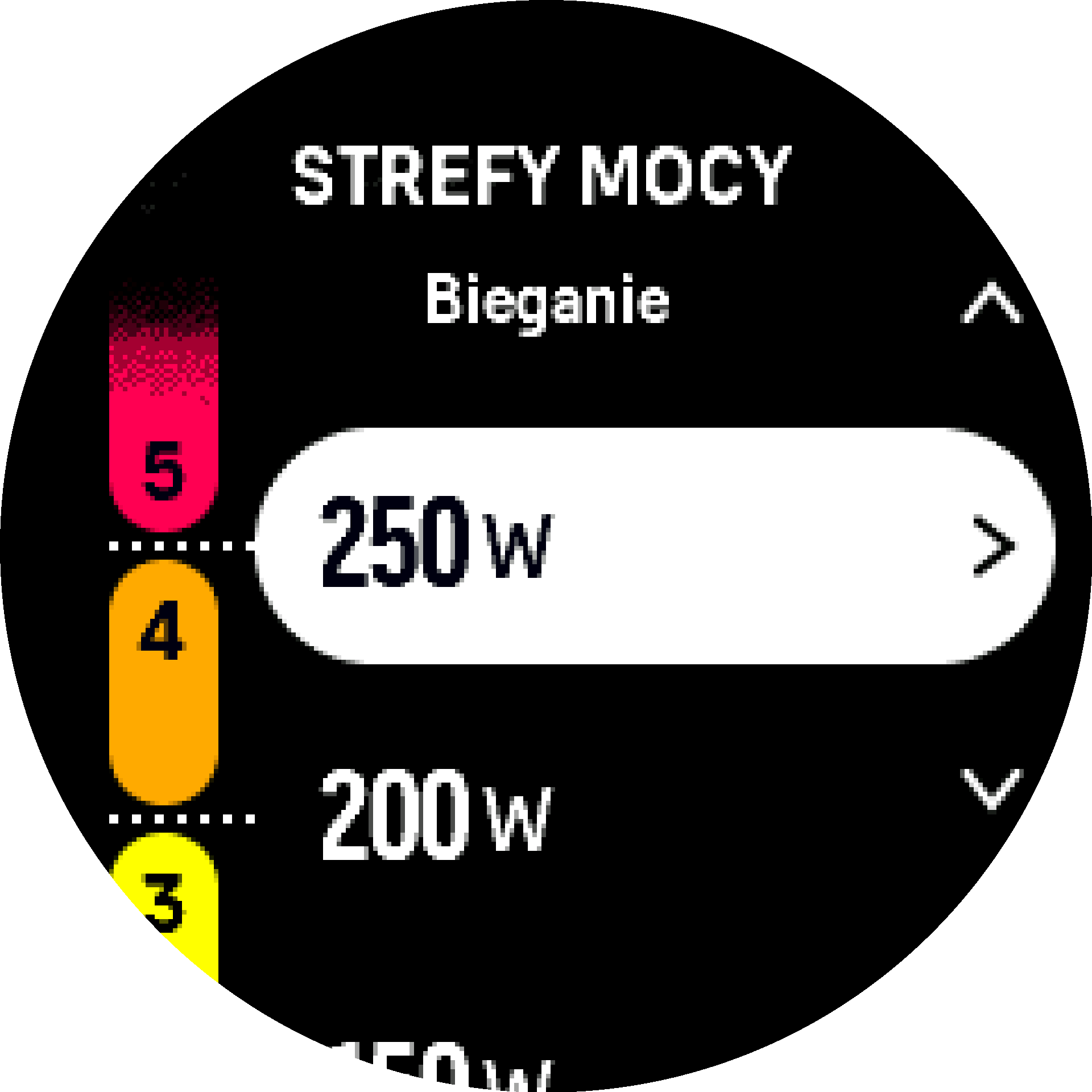

Power zones
Power meter measures the amount of physical effort needed to perform a certain activity. The effort is measured in watts. The main advantage gained with a power meter is precision. The power meter reveals exactly how hard you really work and how much power you produce. It is also easy to see your progress when analyzing the watts.
Power zones can help you train with the correct power output.
Suunto 9 Peak Pro has five default power zones that you can use or you can define your own.
Power zones are available in all default sport modes for cycling, indoor cycling and mountain biking. For running and trail running, you need to use the specific “Power” sport modes to get power zones. If you are using custom sport modes, make sure your mode uses a power POD so that you also get power zones.
Set activity specific power zones
Set your activity specific power zones from the settings under Training » Intensity zones » Advanced zones.
  1. Tap the activity (running or cycling) that you want to edit or press the middle button when the activity is highlighted.
  2. Swipe up or press the lower button and select power zones.
  3. Swipe up/down or press the upper or lower buttons and select the power zone you want to edit.
  4. Select your new power zone by swiping up/down or by pressing the upper or lower buttons.
    Advanced PowerZones S9PP
  5. Press the middle button to select the new power value.
  6. Swipe right or press and hold the middle button to exit the power zones view.
