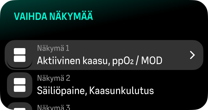

The switch window on the left of the dive screen can contain different types of information that can be changed by short pressing the OK button.
You can customize the information shown in the switch window in Dive settings > Customization> Switch window.
The list shows all views currently assigned to the switch window. Select a view to edit it. The add new view option is available at the bottom (unless the maximum of 10 views is reached).

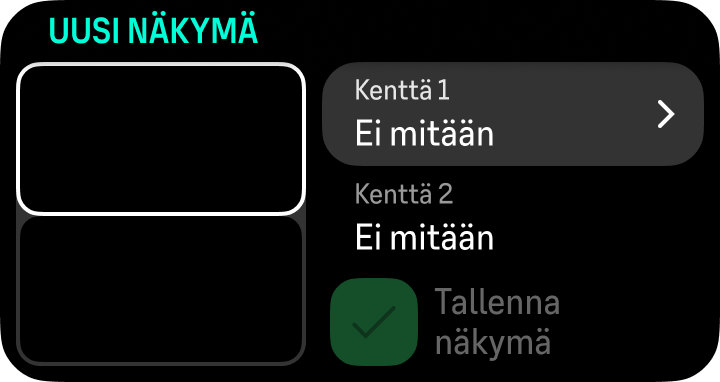

Adding new view

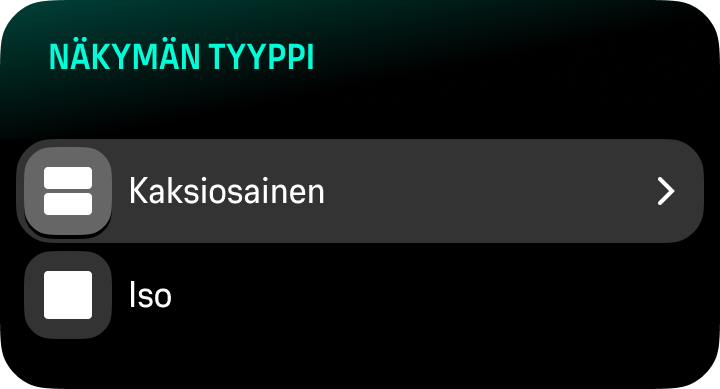

- Select a view type (large or double field). Once selected, view type cannot be changed.
- Select a field to assign a function from the available list. Repeat it for the second field (if using a double field layout).
- Press Save view to confirm.

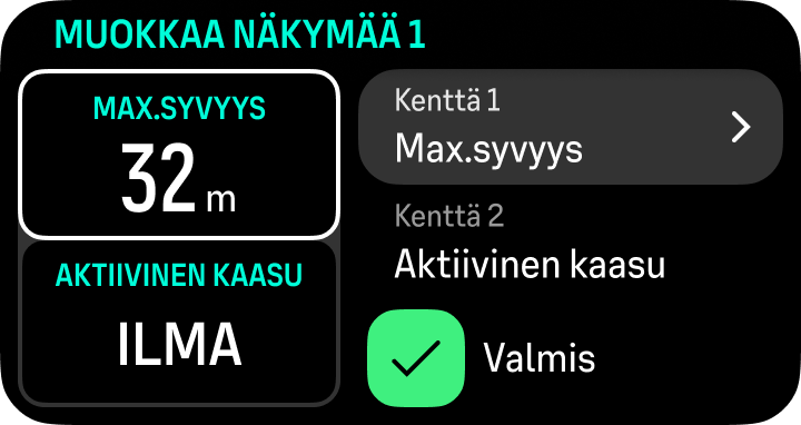

Editing a view
When editing a view:
- The layout type is fixed.
- Fields can be changed at any time.
- Delete view replaces the Save view option.
A view cannot be deleted if it is the only view in the list.
