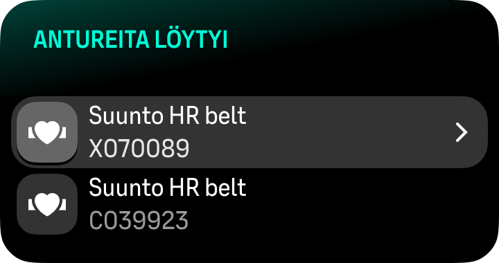

Pairing heart rate sensor
You can pair your Suunto Nautic device with a heart rate belt to track your heart rate during diving.
To pair a heart rate belt:
- Go to Control panel > Connectivity.
- Select Pair new device.
Select the sensor from list.
