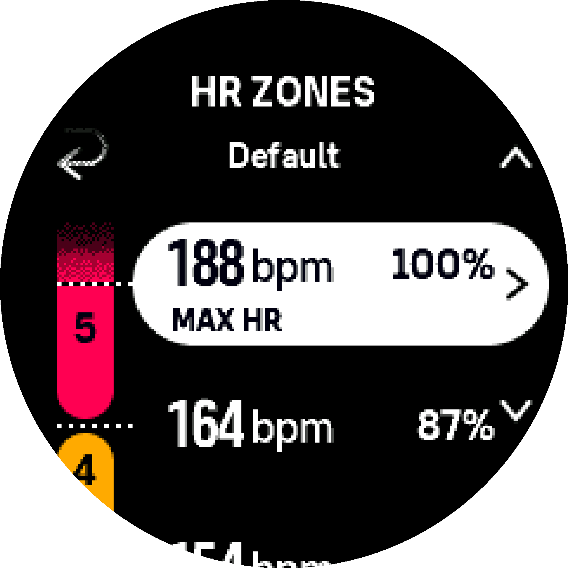

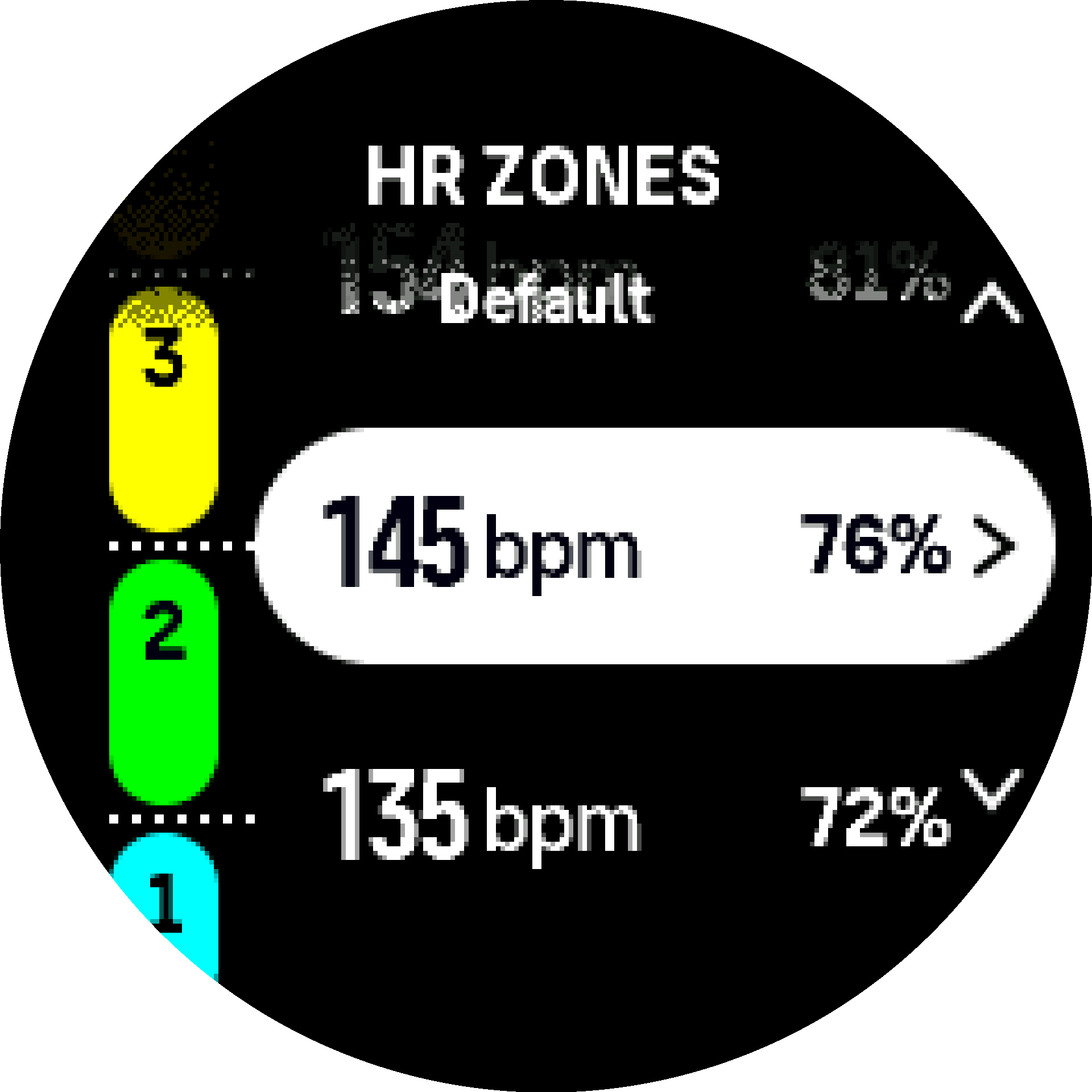

Set default HR zones
Set your default HR zones from the settings under Training » Intensity zones » Default HR zones for all sports.
hr zones item
  1. Scroll up/down and tap or press the middle button when the HR zone you want to change is highlighted.
  2. Select your new HR zone by swiping up or down or by pressing the upper or lower buttons.
    Default HR zone S9PP
  3. Tap your selection or press the middle button.
  4. To exit the HR zones view, swipe right or keep the middle button pressed.
    NOTE:
    Selecting Reset in the HR zones view will reset the HR zones to the default value.

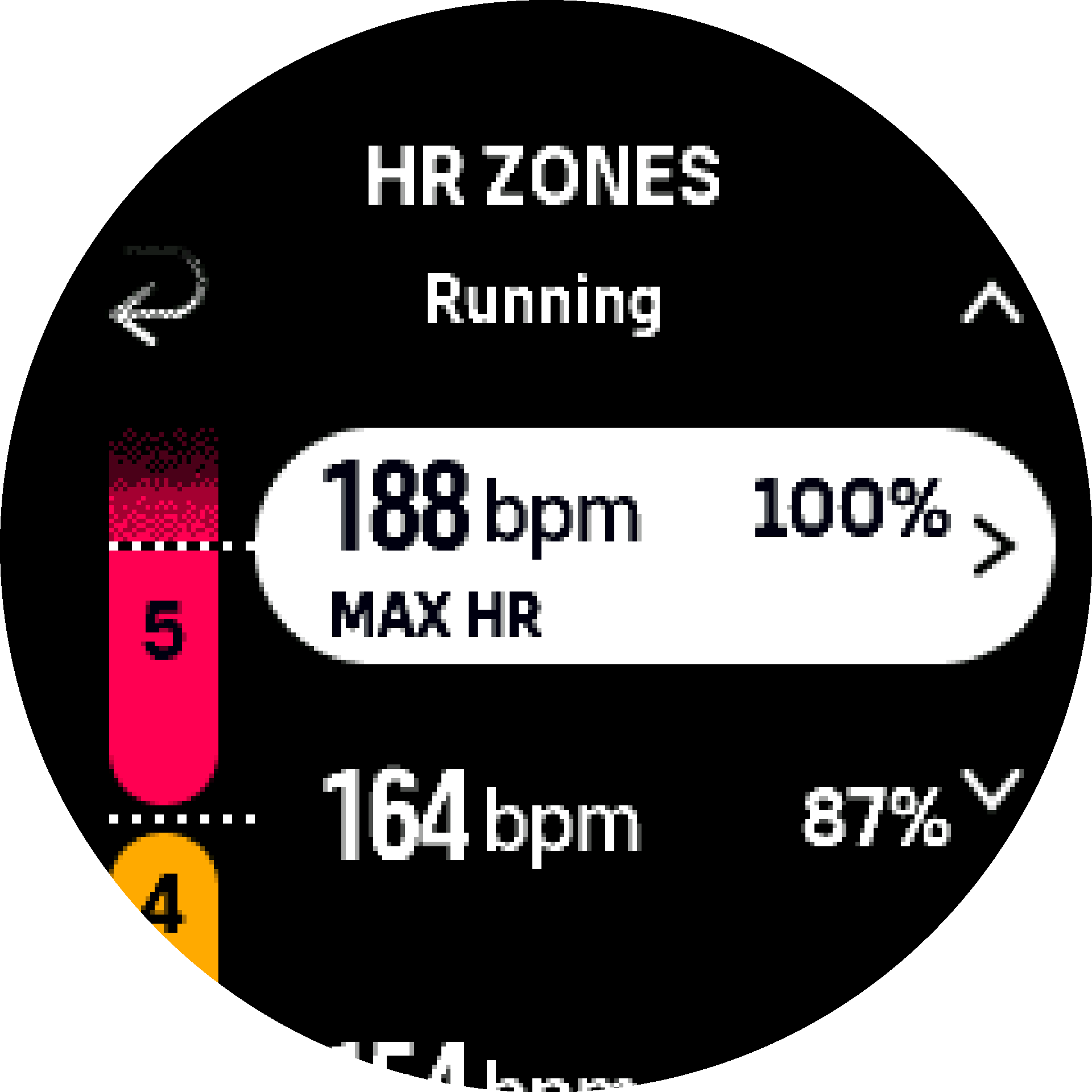

Set activity specific HR zones
Set your activity specific HR zones from the settings under Training » Intensity zones » Advanced zones.
  1. Tap the activity (Running or Cycling) that you want to edit or press the middle button when the activity is highlighted.
  2. Press the middle button to toggle the HR zones on.
  3. Scroll up/down and tap or press the middle button when the HR zone you want to change is highlighted.
  4. Select your new HR zone by swiping up or down or by pressing the upper or lower buttons.
    Advanced HR Zone S9PP
  5. Tap your selection or press the middle button.
  6. To exit the HR zones view, swipe right or keep the middle button pressed.

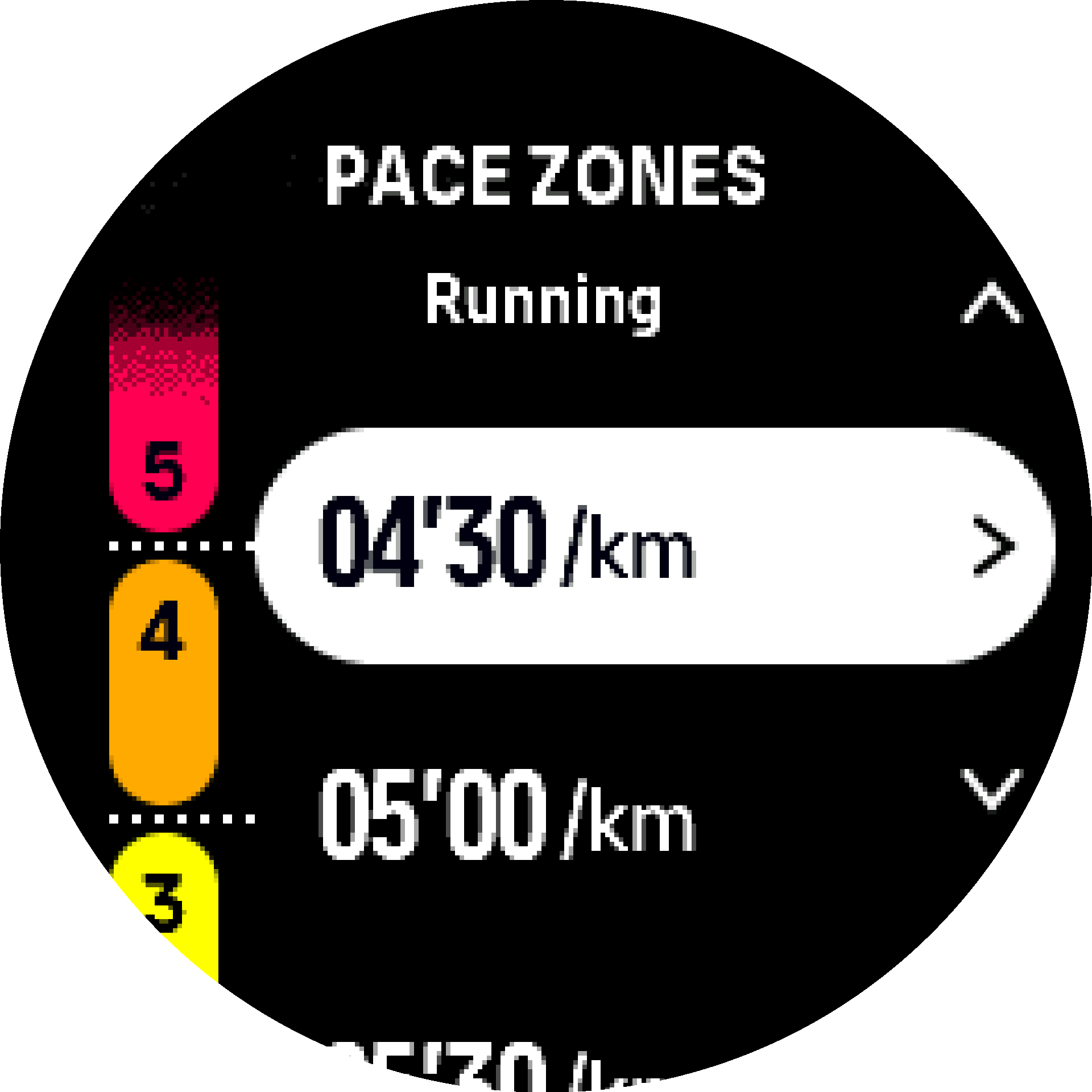

Pace zones
Pace zones work just like HR zones but the intensity of your training is based on your pace instead of your heart rate. The pace zones are shown either as metric or imperial value depending on your settings.
Suunto Ocean has five default pace zones that you can use or you can define your own.
Pace zones are available for running and cycling.
Set pace zones
Set your activity specific pace zones from the settings under Training » Intensity zones » Advanced zones.
  1. Tap Running or Cycling or press the middle button.
  2. Swipe or press the lower button and select pace zones.
  3. Swipe up/down or press the upper or lower buttons and press the middle button when the pace zone you want to change is highlighted.
  4. Select your new pace zone by swiping up/down or by pressing the upper or lower buttons.
    Advanced PaceZones S9PP
  5. Press the middle button to select the new pace zone value.
  6. Swipe right or press and hold the middle button to exit the pace zones view.
