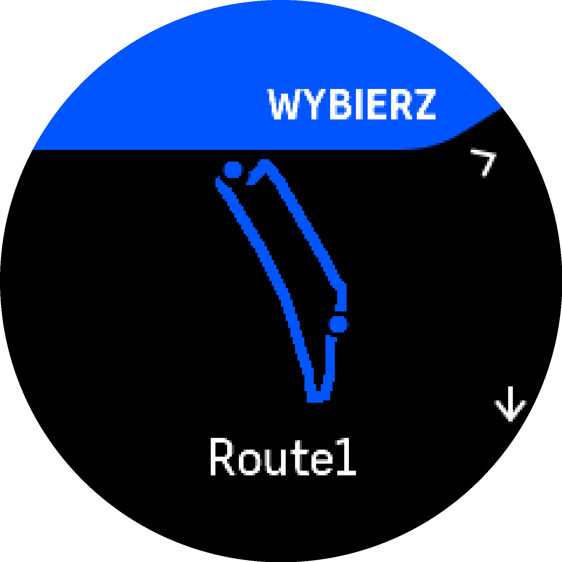

  3. Scroll to Routes and press the middle button to open your list of routes.
  4. Scroll to the route you want to navigate to and press the middle button.
    Routes list S9PP
  5. Select the route by pressing the upper button.

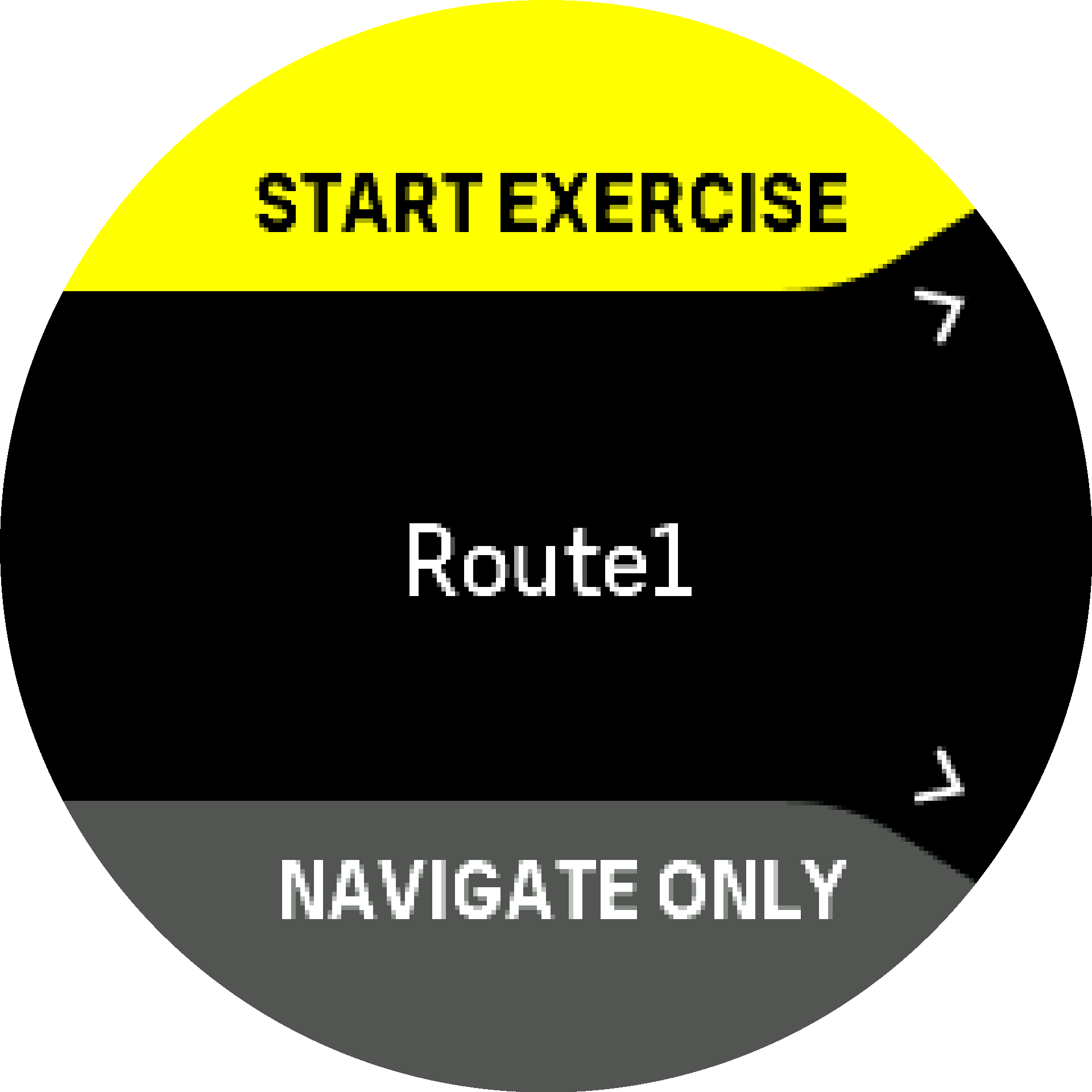

  6. Select Start exercise if you want to use the route for exercising or select Navigate only if you only want to navigate the route.
    Routes Exercise S9PP
    NOTE:
    If you only navigate the route, nothing will be saved or logged in Suunto app.
