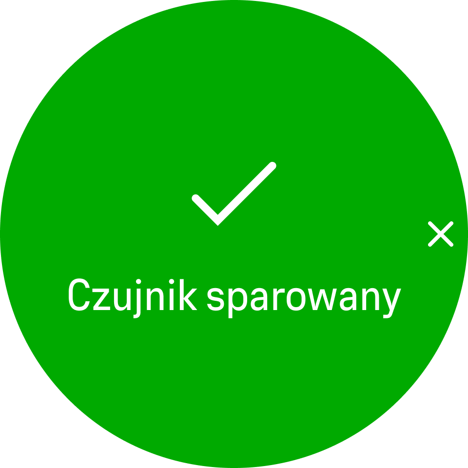

  1. Follow the instructions in the watch to complete pairing (refer to sensor or pod manual if needed), press the middle button to advance to the next step.
Sensor paired S9PP
