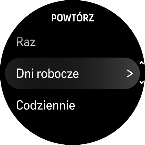

  4. First select how often you want the alarm to sound. The options are:
    Once: alarm sounds once in the next 24 hours at the set time
    Weekdays: alarm sounds at the same time Monday thru Friday
    Daily: alarm sounds at the same time every day of the week
    alarms Phoenix step2
