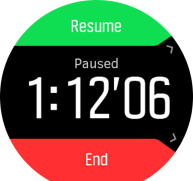

  7. Press the upper button to pause the recording. Stop and save with the lower button or continue with the upper button.
    Recording paused Spartan

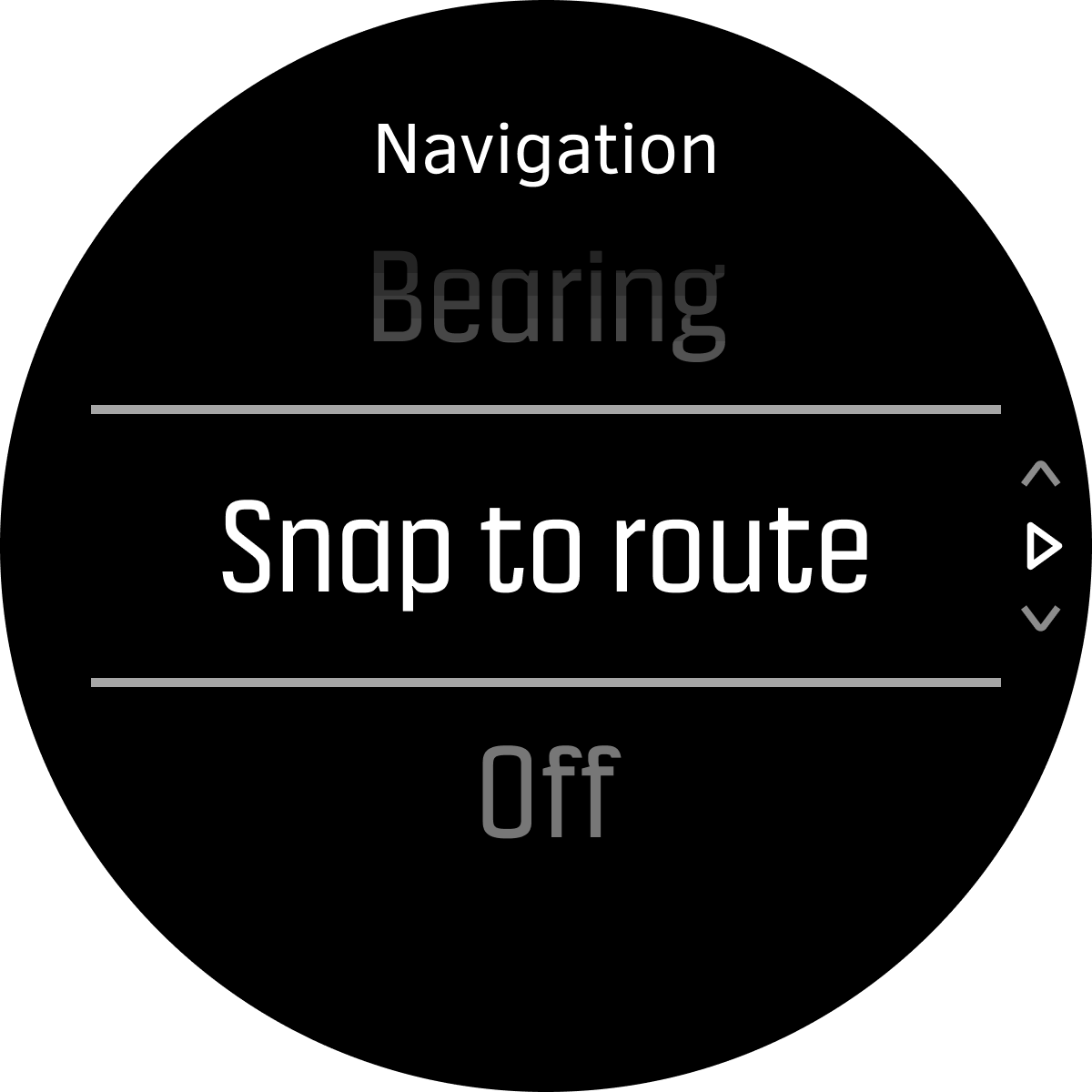

Snap to route
In urban surroundings the GPS can struggle to follow you correctly. If you select one of you predefined routes and follow that route, the watch GPS is used purely to locate where you are on the predefined route, not actually creating a track from the run. The recorded track will be identical to the route used for the run.
Snap To Route
To use Snap to route during exercise:
  1. Create a route in Suunto app and sync your watch if you haven't done so already.
  2. Select a sport mode that uses GPS and then swipe up or press the lower button to open the options.
  3. Scroll to Navigation and tap it or press the middle button.
  4. Select Snap to route and press the middle button.
  5. Select the route you want to use and press the middle button.
  6. Press the upper button or tap Navigate.
Start your exercise as normal and follow the selected route.

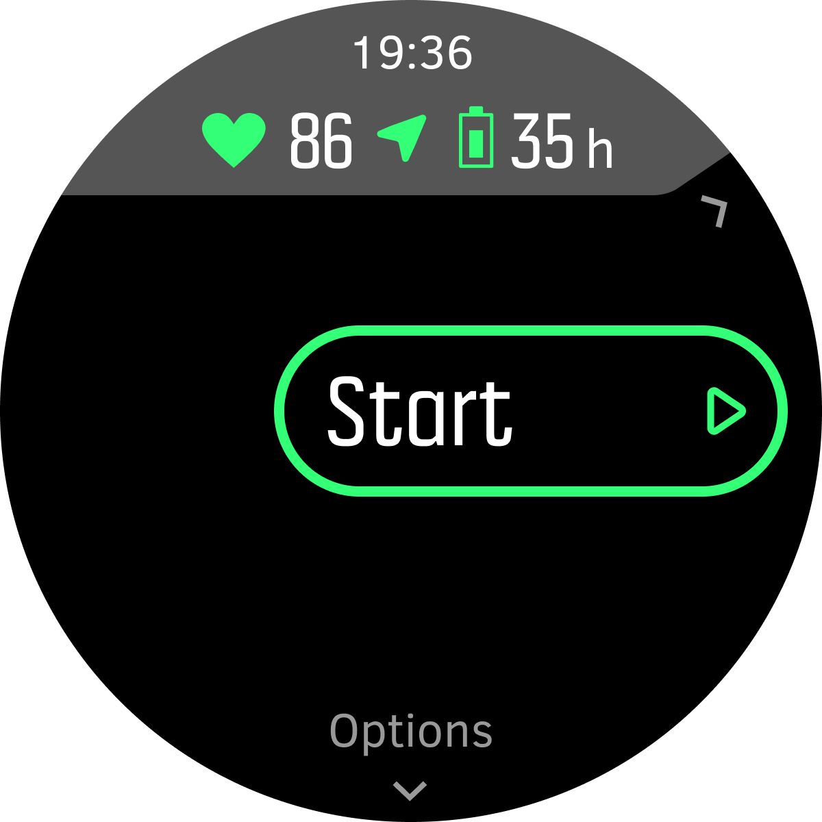

Your Suunto 9 has a battery power management system uses intelligent battery technology to help ensure you watch does not run out of power when you need it most.
Before you start recording an exercise (see Recording an exercise) you see an estimate of how much battery life you have left in the current battery mode.
Running mode start S9 Peak

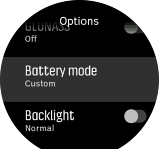

There are four predefined battery modes; Performance (default), Endurance, Ultra and Tour. Changing between these modes will change the lifetime of the battery but also change the performance of the watch.
NOTE:
By default, Ultra and Tour mode disable all HR tracking (both wrist and chest). To enable HR tracking (in Ultra and Tour mode) go to Options under the start indicator.
While in the start display, tap Options » Battery mode to change battery modes and see how each mode affects the performance of the watch.
Battery Modes S9
You can also quickly change the battery mode in the start display by pressing the upper button.
In addition to these four predefined battery modes, you can create a custom battery mode with your own desired settings. The custom mode is specific for that sport mode, making it possible to create a custom battery mode for every sport mode.
NOTE:
If while exercising you start navigating or use navigation data like estimated time of arrival (ETA), the GPS goes to Best, regardless of the battery mode.

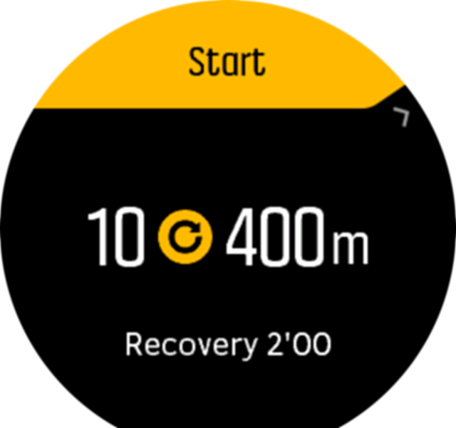

Interval training
Interval workouts are a common form of training consisting of repetitive sets of high and low intensity efforts. With Suunto 9, you can define in the watch your own interval training for each sport mode.
When defining your intervals, you have four items to set:
  • Intervals: on/off toggle that enables interval training. When you toggle this on, an interval training display is added to your sport mode.
  • Repetitions: the number of interval + recovery sets you want to do.
  • Interval: the length of your high intensity interval, based on distance or duration.
  • Recovery: the length of your rest period between intervals, based on distance or duration.
Keep in mind that if you use distance to define your intervals, you need to be in a sport mode that measures distance. The measurement can be based on GPS, or from a foot or bike POD, for example.
NOTE:
If you are using intervals, you cannot activate navigation.
To train with intervals:
  1. Before you start an exercise recording, swipe up or press the lower button to open the sport mode options.
  2. Scroll down to Intervals and tap the setting or press the middle button.
  3. Toggle intervals on and adjust the settings described above.
    Interval training settings
  4. Scroll back up to the start view and start your exercise as normal.
  5. Swipe left or press the middle button until you reach the intervals display and press the upper button when you are ready to start your interval training.
    Interval training start
  6. If you want to stop the interval training before you have completed all your repetitions, keep the middle button pressed to open the sport mode options and toggle off Intervals.
NOTE:
While you are in the intervals display, buttons work as normal, for example, pressing the upper button pauses the exercise recording, not just the interval training.
After you have stopped your exercise recording, interval training is automatically toggled off for that sport mode. The other settings, however, are maintained so you can easily start the same workout the next time you use the sport mode.

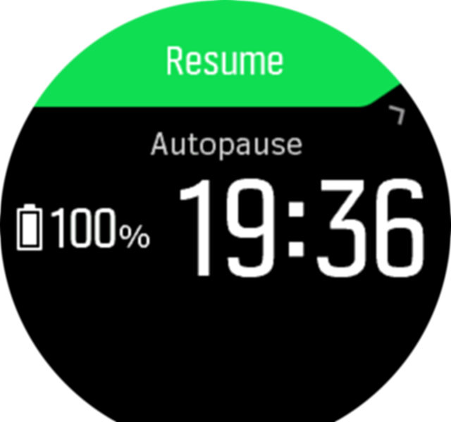

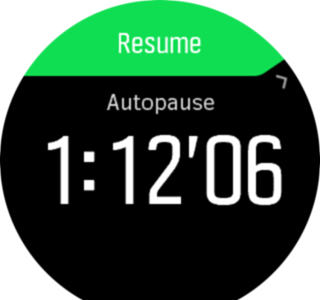

Autopause
Autopause pauses the recording of your exercise when your speed is less than 2 km/h (1.2 mph). When your speed increases to more than 3 km/h (1.9 mph), the recording continues automatically.
You can turn autopause on/off for each sport mode the sport mode settings in the watch before you start your exercise recording.
If autopause is on during a recording, a pop-up notifies you when the recording is paused automatically.
autopause
Tap the resume pop-up to check the current time and battery level.
autopause time
You can let the recording resume automatically when you start moving again, or manually resume from the pop-up screen by pressing the upper button.
