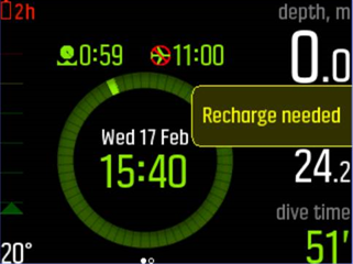

A pop-up message indicates when recharge is needed.
rechargeneeded
