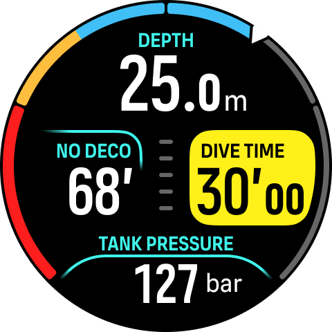

In addition to the audible and vibration options, you can choose between two different appearance options: Notify (cyan) or Caution (yellow). You can define a maximum of five alarms for each configurable alarm and once an alarm appears, you can clear it by pressing any button.

Dive time alarms can be defined in minutes and seconds to a maximum of 99 min.
divetime alarm

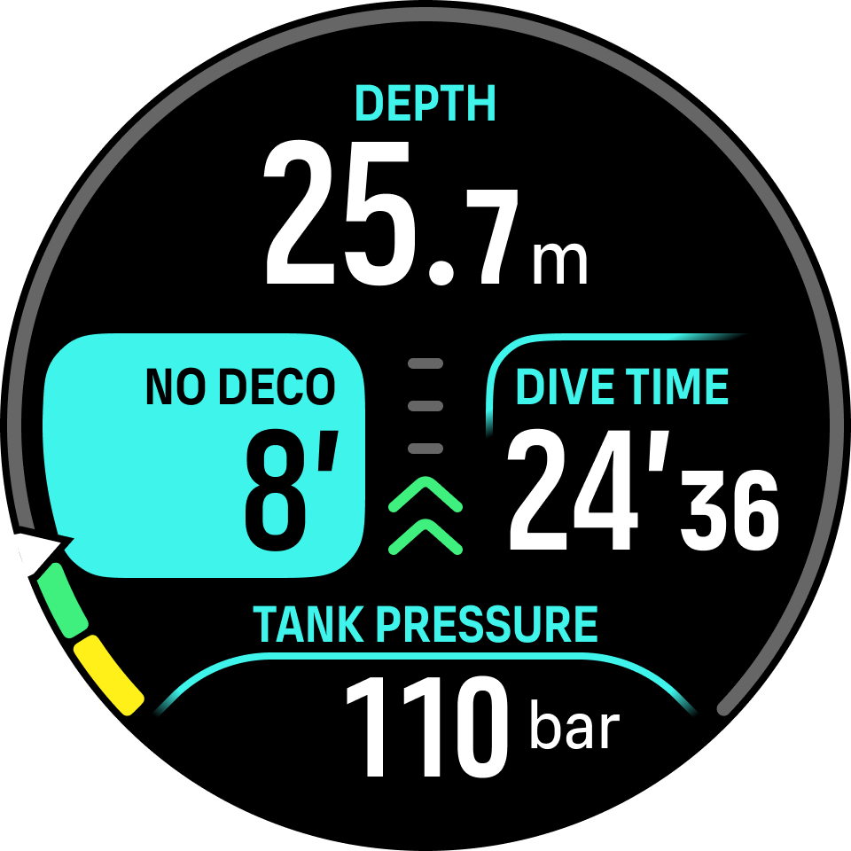

NDL
No decompression limit (NDL) alarms can be defined to alert you of a certain NDL or when you are low on NDL time.
NDl alarm NEW

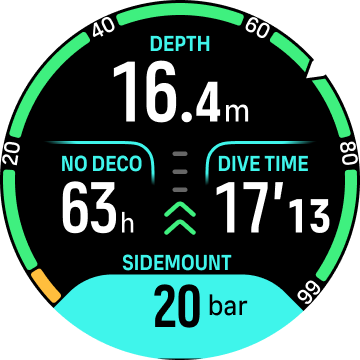

Sidemount
If you have 2 Tank PODs paired to the same gas, you can define a pressure difference so that the device alerts you when to switch tanks. You can set the pressure difference threshold between 5 and 70 bar (73-1015 psi). Once the pressure difference reaches the set limit, you get an alert in the switch window.
7 sidemount
