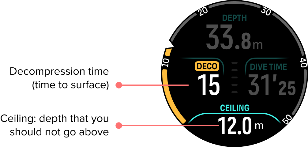

When you exceed the no-decompression limit, Suunto Nautic S provides the decompression information required for ascending. Ascent information is always presented with two values:
  • Decompression time (also referred to as Time to surface): optimum ascent time in minutes to surface with given gases
  • Ceiling: depth that you should not go above

Once the No deco time is at 0 min, the display area will change to show the Deco time, the ceiling value will be displayed in the switch window and the arch will turn to orange indicating the same deco time. An alarm is also triggered that can be confirmed with any button press.
decompression dives no deco time2
Deco time is referring to the recommended ascent time in minutes to the surface (TTS).
