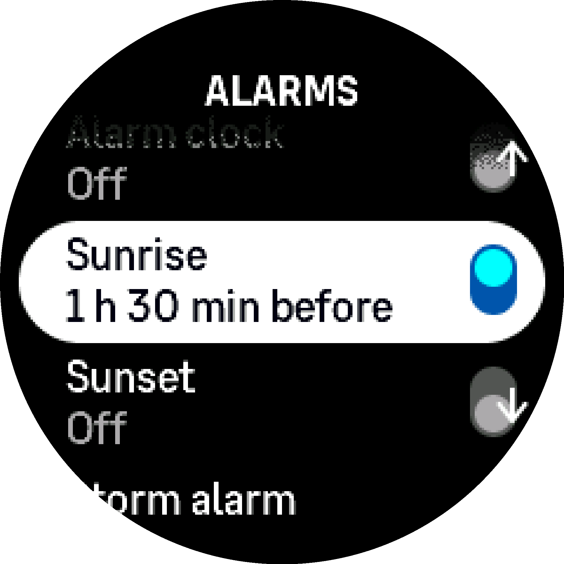

  1. From watch face, long press the middle button and scroll down to and select Alarms.
  2. Scroll to the alarm that you want to set and select by pressing the middle button.
    SunriseSunset alarm toggle S9PP

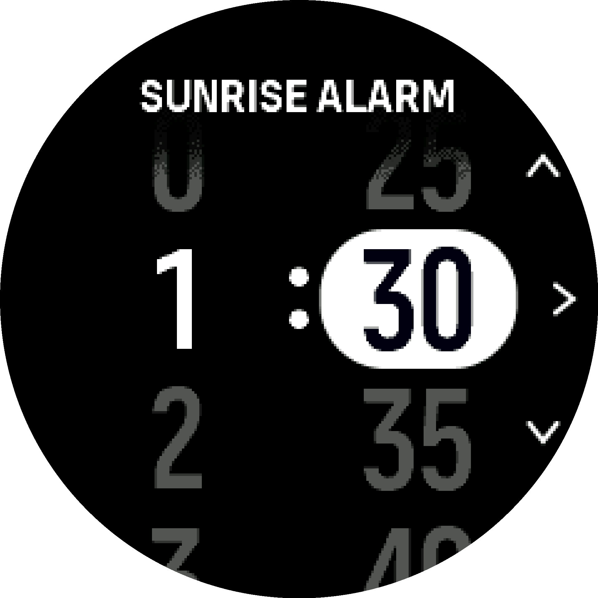

  3. Set the desired hours and minutes prior to sunrise/sunset by scrolling up/down with the upper and lower buttons and confirming with the middle button.
    Time before sunset sunrise S9PP
  4. Press the middle button to confirm and exit.
