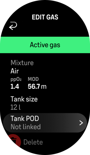

  2. In the Gases menu, select the gas you want your Tank POD to link with.
  3. Go to the Edit gas view and scroll to the Tank POD setting.
    6.1 how edit gas

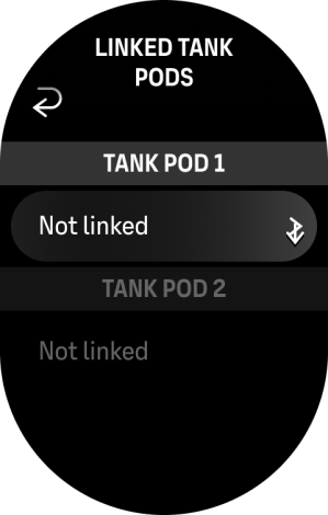

  4. If you are diving with one tank, add your Tank POD to the 'Tank POD 1' slot and continue with step 5. If you are diving sidemount and you need to link a second Tank POD to the same gas, follow the same procedure for the 'Tank POD 2' slot.
    6.1 how linked tank pod

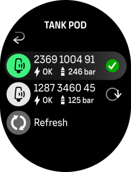

  1. Make sure the Tank POD has been activated and that it is within range. Select your Tank POD serial number from the list.
    6.1 how tank pod

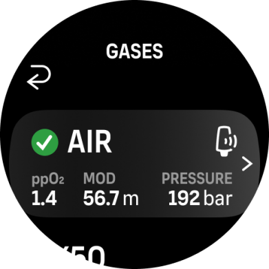

If you have linked the same Tank POD to several gases, remember to check before your dive that you have the right active gas and that you have your Tank POD linked. In the dive main views, only one tank pressure is shown
6.1 how gas
